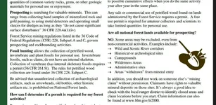

From the FS website...

Sand, Gravel, and Decorative Rock Permits may be obtained from various pre-approved areas on the Forest with a personal use permit. These permits are free, however, material may only be removed from specific areas.
Permits are not generally required for non-commercial personal use (recreational) metal detecting, rock collecting (hounding), gold panning (dry wash or manual pan, not using any type of powered equipment, such as a sluice or dredge). Digging in the forest for any purpose is not permitted.
USDA Forest Service - Recreation, Heritage and Wilderness
