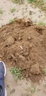

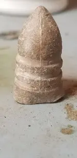

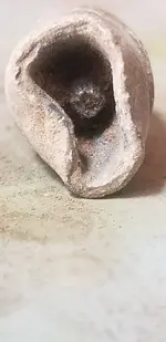

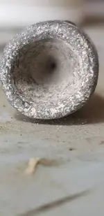

I hunted a 1854 old fort site and this , at first I thought it was a minie ball but it looks different. Any help IDENTIFYING this 20190526_090355.webp20190526_120937.webp20190526_122202.webp20190526_120946.webp20190526_122213.webp
It's a minie ball...but a darn weird one. It looks like casting has failed in some way. I have no idea what kind it is though without checking my book.
It does have the look of a 'Georgia Teat Variant' but that long skirt ??? & Big Teat ! ; Is the teat lead as well ? (re-cut mold is possible.)

Jimzz927, the finder of the unidentified Minie-bullet, has not yet answered Davers' 26-hours-old question, "Is the teat lead as well?"... so, the answer is very important information. I'm re-asking the question because the "teat" looks quite unusual, being unlike any bullet-base teat I've seen previously. So, I'm wondering if it is actually part of the lead bullet or a piece of "foreign matter" that somehow is lodged in the bullet's base-cavity.
Although the "teat" makes this bullet sorta resemble a Confederate Augusta (Georgia) Arsenal "teat-base" bullet (see the photo helpfully posted by Davers), it has a much shorter nose and "taller" base than those types do.
A bullet's dig-location is often important for determining its correct identification. This one's finder lives in New Mexico. A lot of "weird" (extremely unusual) civil war era bullets have come from what at that time was called the Trans-Mississippi Department. That area received comparatively few military supplies from the more-Eastern armies, and thus had to provide their own locally-made supplies. Particularly on the Confederate side, that is why relic-diggers in that part of the country find several varieties of "oddball" bullets which never got sent east of the Mississippi River.
If this bullet does indeed have an integral lead teat in its base-cavity, it is definitely Confederate. The yankees never made any teat-base minies. (Note, the teat-base Sharps is not a Minie-type bullet.)

Ok thank you, and yes the teat is lead, alittle history where i found it. It was Ft. Fillmore, NM inwhich the confederates took over 1861and union then tookover in 1862 after a battle. im going take my bullet to get in sized and then post it .

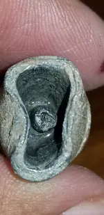

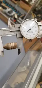

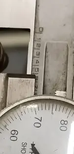

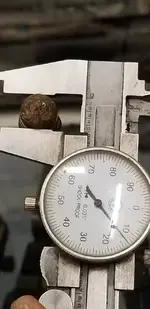

Ok these are the measurements, wieght was 479 grains

I asked about the Teat material cause it looked like Iron maybe in the first picture , now it looks to be Lead or maybe Pewter but I don't see a reason it would be Pewter.

P.S. I misread ,& see the teat is indeed lead ..COOL!:icon_thumright:

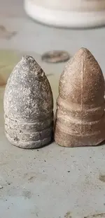

I will try to post a couple examples of the only Teat base bullets I have dug.
015.webp010.webp.
Thanks davers for ur help I really appreciate it, I hope to figure out what kind of bullet it is . U right kind of look like ur but???
