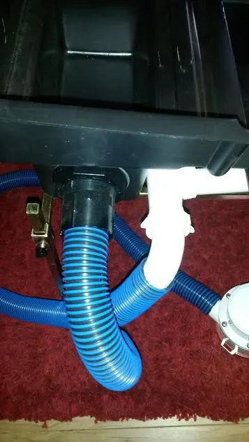

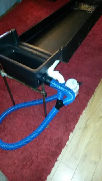

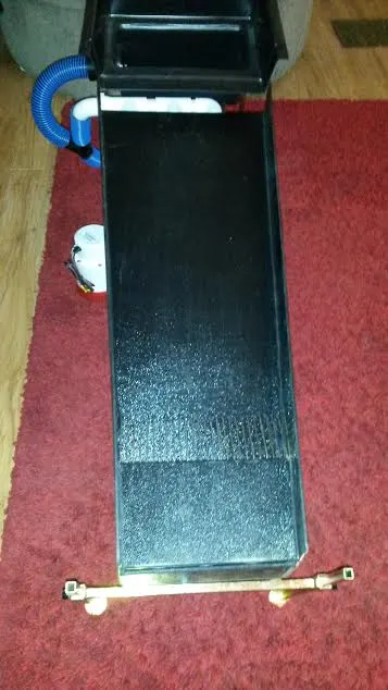

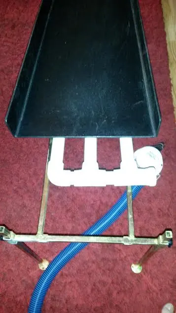

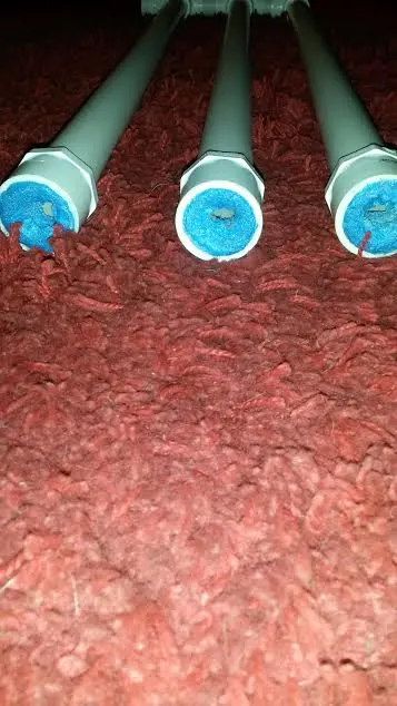

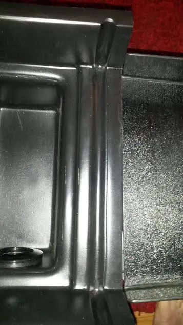

The weather is nice finally so it's time to pull everything out of the basement, go out back on this nice warm sunny day and try to finish up this project. The water supply is a 3,700 GPH electric pump powered with a lightweight small, super quiet generator. I still need to glue the PVC pieces, make a bracket to secure the waterfall and sluice when using, rig up something to hang the pump underneath, and make a trash screen to go around the pump. I am doing this project because it's fun, and a lot of places of interest don't have enough water flow. This whole setup fits in my backpack along with a 14 inch gold pan, container, food and water. Bazooka owners with any input or advice on this idea would be appreciated. Thanks, Jay

Two questions:
1. Do you have a valve in there somewhere to control flow between the fluid bed vs. the waterfall?
2. What is the blue stuff on the ends of the tubes feeding the fluid bed?
Looks like it'll work great btw. Eager to see a video!
Hey Kevin,
Thanks, I hope it works! As for the blue stuff. That is 3/4 inch heavy duty foam from an exercise mat bought at Walmart for 5 dollars. The reason I put it in the end of the tubes is to try to keep the water feed isolated to the fluid bed input tubes only. No, I don't have a valve, but could easily put one in. Do you think it would be needed?
your gonna need a bigger pump
Hey Kevin,
Not sure if you'll need a valve, I just imagine you might but it's an added cost so just do it if needed.
Hey Goldwasher, I was thinking that the sealed fit of the PVC pipe over the input tubes to the fluid bed would beef up the water pressure to the fluid bed. The idea is higher water pressure to the fluid bed, and more volume to the spillway on top. What do you think?
Kevin, I thing I'll give it a test run first, and then see if I need one. I'm hoping the reduced pipe where it goes to the fluid bed is going to really up the pressure to the jets in the fluid bed, while filling the top effectively.
Upping the fluid bed pressure may be a very bad idea. I am quite eager to hear how it goes. Lots to learn here!
Kevin is right you don't want too much pressure. Luckily and unfortunately for you ...you have a bilge pump so pressure won't be an issue. In our testing an open flow to the trap(if there is no valve for control) is essential. Creating a mock up of a creek seems to be the best bet. Up to the snipers its doable with portability.

If you want to run that outfit as a concentrator and only feed it classified material 1/4" or less then your pump should be adequate.
However you will need way more gpm than that pump is capable of to run unclassified material and get satisfactory results.
I tried it once using two separate pumps, one not quite as powerful as yours (2400 gph) for the top deck and a smaller one (800 gph) for the trap. The trap would stay fluidized but there was just not enough flow on the top deck to move the unclassified material at a rate necessary for timely feeding or without spending time helping the material progress by hand. Panning would have been faster.
One thing that may come in handy is to place your highbanker assy into a slow moving creek and let your pump assist by boosting the flow down the deck.
It appears from the photo that you allowed enough space under your waterfall for the above scenario to operate successfully under certain conditions.

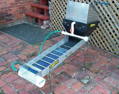

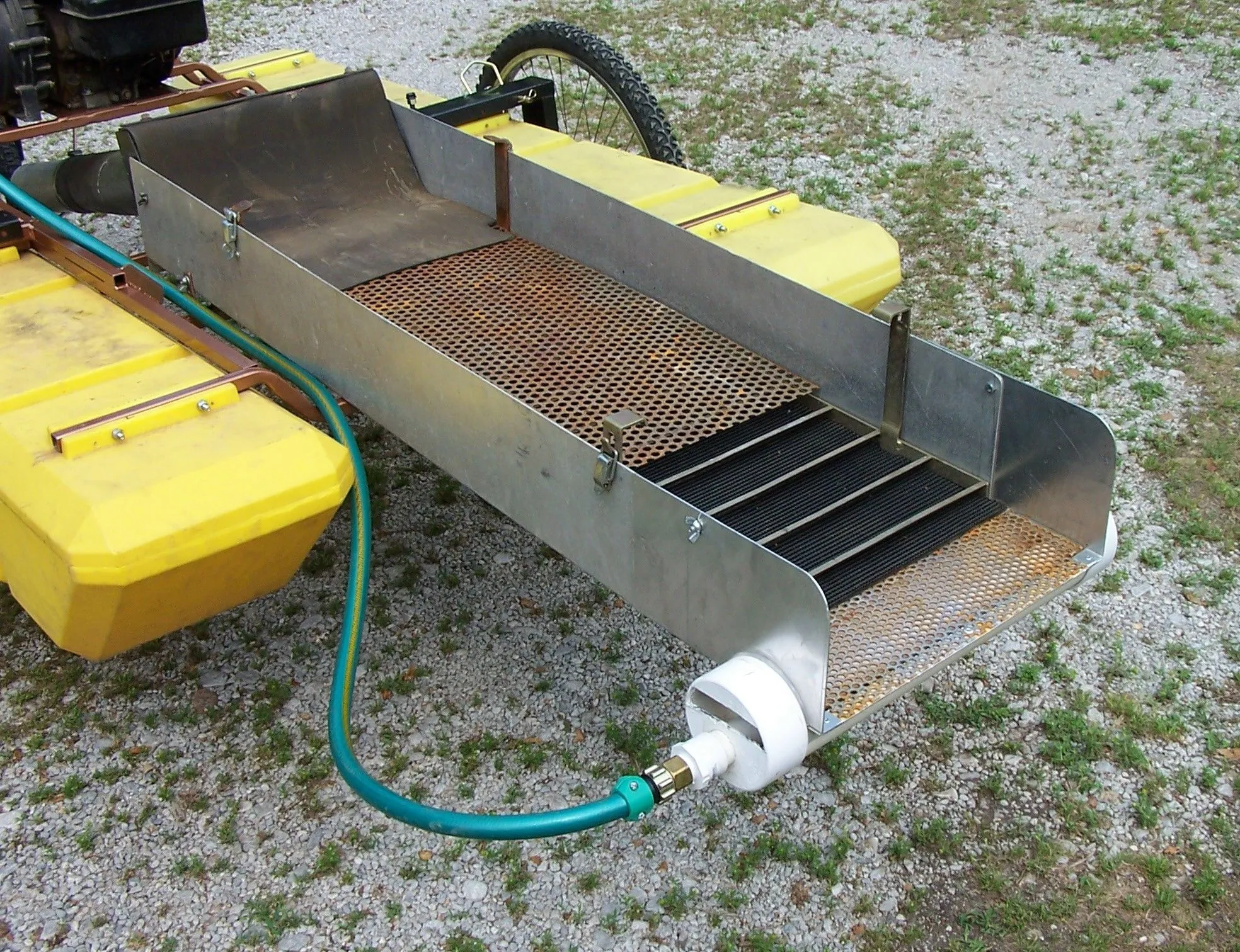

Might I suggest building a steel fluid box for the end of any highbanker. Just weld up a deep steel box with a lip on the upper end same width as your sluice on the highbanker and wala! Fluid bed catch just like I have on my trommel. It works on any trommel or highbanker.
Got a photo?
This is what I use on the end of mine made from PVC......
I call it "Add a Trap" and it works like a charm on the end of highbanker, trommel, or even a dredge.
