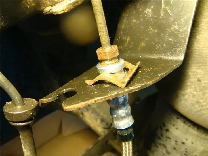

Well now, this is where the brain took a left turn and anyone familiar with C-clips or brake hose retainers may see where it went.
If you were to cut the base out of a second bucket and cut a slice the width of the sluice where it enters the first bucket, as you slide the second bucket into the first, the second bucket will keep the sluice from sliding out.
Then, cut and bend the other 3 sides so they direct the material onto the sluice. The water can be pumped into the outer bucket towards the fluid bed intake, and as it fill the void between buckets, flow up and out slots cut towards the top of the second bucket creating the flow over the top of the sluice.
