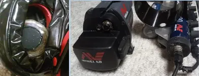

Modified my Excalibur ll last night with gray ghost Amphibian headphones and I love it, thank you:thankyou: to Joe oldbeechnut for sending me the kit... took it out today to test it out and everything is a ok.. I found this 1946 silver quarter no gold today but tomorrow is another day.....:cool:

Better but they do not meet my standards for the CTX other then comfort. One reason I bought a CTX to make a better set of headphones for it, have a few sets out testing right now with CTX hunters, one is a diver and has about 24 hours under and they still work great..he dives in the area of 10 feet with the CTX...these have the same audio speakers as the Black Windows, Sunray Pro Golds... BY far the best for the CTX. I also have one set out using the same speakers as the old rat phones..richer audio.. stay tuned.

Both can share the same headphones, which are the speakered headphones I spoke of... 100% water proof and the best for multivariable tones...same speakers as the Sunray Pro Golds, Black Widows, Jolly Rogers..Detector Pro...etc... Also a set using the Old Rat Phone speakers, Kobitones 500's, a deeper smoother bass audio...
But I do have one special set that I use for PP hunting that are a killer, they don't work well on the CTX but allow the faintest of faints to be heard, only good in PP (on the Excalibur) and the tones are not the best. But you can watch another hunter laying out the target trail (lane) by the targets he digs, then jump in his lane behind him and Dig targets he missed because he did not hear them.
