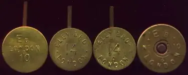

Also, muzzleloader roundballs don't "take the rifling" like that ball did, because muzzleloader balls are smaller than the firearm's bore. So, I have to think that ball was fired from a breechloader. Perhaps that ball was in an early Pinfire breechloading Shotgun cartridge. Fourteen-gage would be about right for that ball's size.
That being said... let me also state plainly that at this point, my Pinfire-cartridge theory is just speculation, because I don't know for certain that any Pinfire shotgun cartridges came with a roundball as the "slug." I'll have to go do some research about that.
Meanwhile, here's a photo of some early Pinfire shotgun cartridges, made by Eley Brothers of London in the second half of the 1800s.

Actually, the bullet book by McKee-&-Mason lists a civil war era "French Augustin Rifle & Carbine" which was .71-calibr and had 12 rifling-grooves. But Mangum's photo of the ball with a penny for scale shows the ball is smaller than .71-caliber size.
