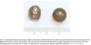

Hello everyone, I recently found this on the web, thought it was interesting, about Girandoni air rifles and Girandoni style air guns. This is an example of a recently fired one made for a museum. From reading this, the caliber seems off but this is close. Google Image Result for http://www.beemans.net/images/BGR-balls-9k.jpg

That is an interesting gun!! I would love to have a reproduction!
