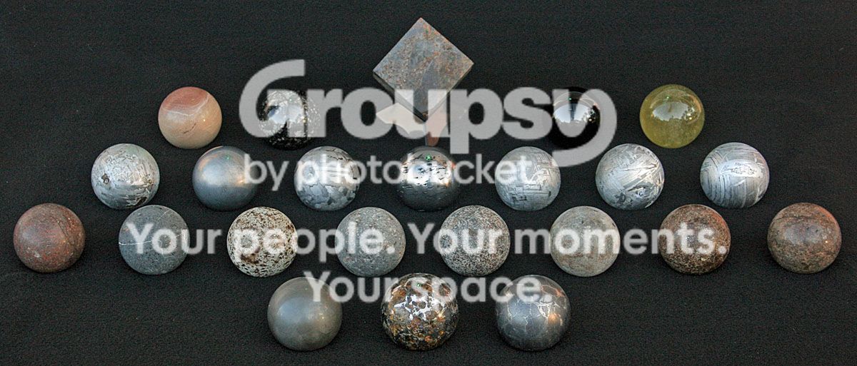

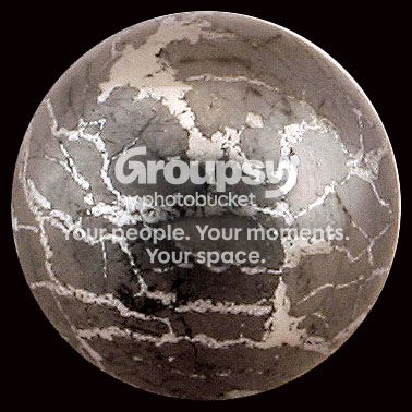

So far I have collected 20 meteorite or meteorite related spheres and I just bought a Mesosiderite, which has been very difficult to locate at an affordable price

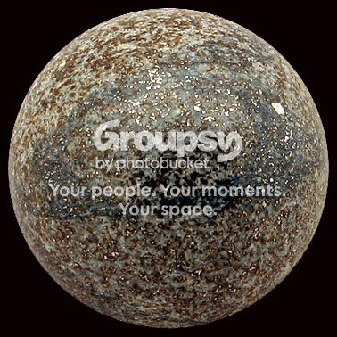

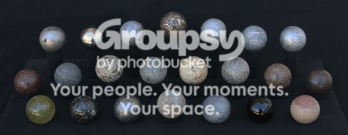

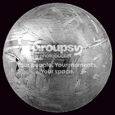

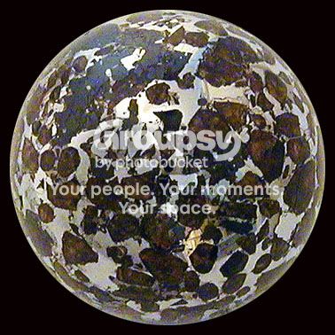

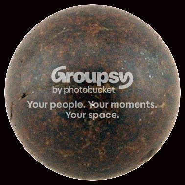

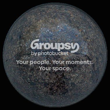

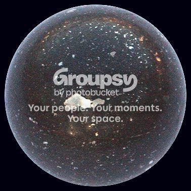

Here is my collection, the individual images are listed in the order they were obtained.

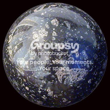

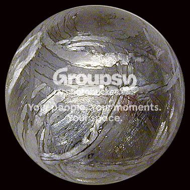

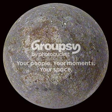

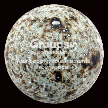

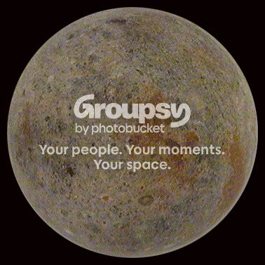

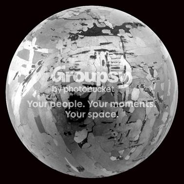

GIBEON
IAV / FINE OCTAHEDRITE IRON- 488 GRAMS
NWA 869
L3/6 CHONDRITE - 225 GRAMS
CAMPO
IAB-MG / COARSE IRON - 485 GRAMS
BRAHIN
PALLASITE - 335 GRAMS
SEYMCHAN
IIE / UNGROUPED IRON - 520 GRAMS
GUANG DONG
TEKTITE - 145 GRAMS
NWA 2828
EL3 CHONDRITE - 158 GRAMS
DRONINO
ATAXITE / UNGROUPED IRON- 536 GRAMS
GAO-GUENIE
H5 CHONDRITE - 227 GRAMS
URUACU
IAB-MG / COARSE IRON - 533 GRAMS
NININGER
MUSEUM WALL BRICK- 171 GRAMS
BLACK ONAPING
SUDBURY IMPACT MELT- 185 GRAMS
TOLUCA
IAB-sLL IRON- 528 GRAMS
CANYON DIABLO
GRAPHITE NODULE- 247 GRAMS
NWA 791
L6 CHONDRITE - 220 GRAMS
DHOFAR 1289
L4 CHONDRITE - 214 GRAMS

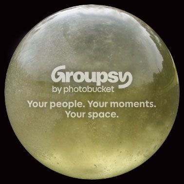

LIBYAN GLASS
IMPACT MELT GLASS - 147 GRAMS
ZAG
H3/6 CHONDRITE - 246 GRAMS
GHUBARA
L5 CHONDRITE - 230 GRAMS
DHOFAR 1724
H4 CHONDRITE - 222 GRAMS
Good luck with your collection, and thank's for sharing. :occasion14:

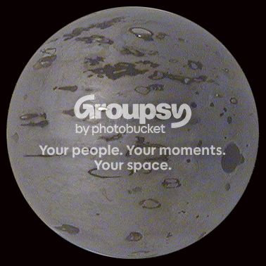

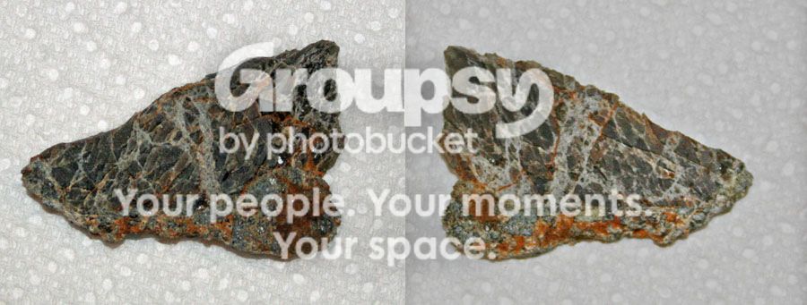

When I saw your first post, I was uncertain about one of the spheres, that melt glass one to be exact. It looked so different from the others.
It looked surprisingly like a "mill marble"... these are marbles that are melted to make fiberglass. I find them in mill towns where fiberglass was once produced. Your close ups show that indeed is not a mill marble.

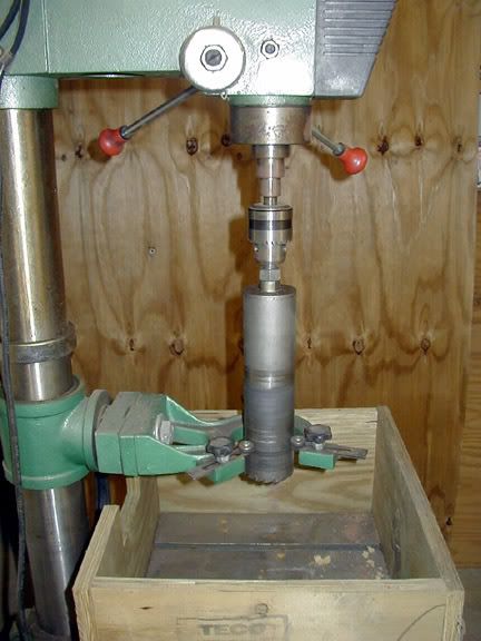

This is the core machine I used to make my first iron sphere from a 57 pound Campo Whole Specimen
It took 2 days and it resulted in a 7 1/2 core that was just over 2” in diameter
I had that core turned on a lathe into 2 separate spheres, one for m y collection and one for eBay. I also sold the remaining whole specimen on eBay for more then I paid for it.
Because it was so time consuming that was the only time I used it.

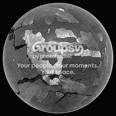

Now I have a machine shop that turns a 51mm x 51mm x 60mm rough into my 50mm sphere
This is the steel prototype
Once I polish it I remove the hexagonal stem, sand and polish that area and then I etch the entire sphere

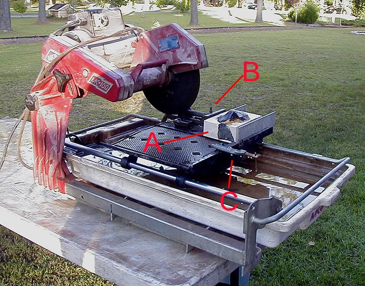

I modified an MK-100 Brick and Paver saw so that I could cut stones and irons to make my sphere roughs
Instead of using a band saw with a kerf so wide that you get 25-30% cut I use a .030” abrasive blade that produces slices that are almost ready to etch with about 5-7% cut loss.

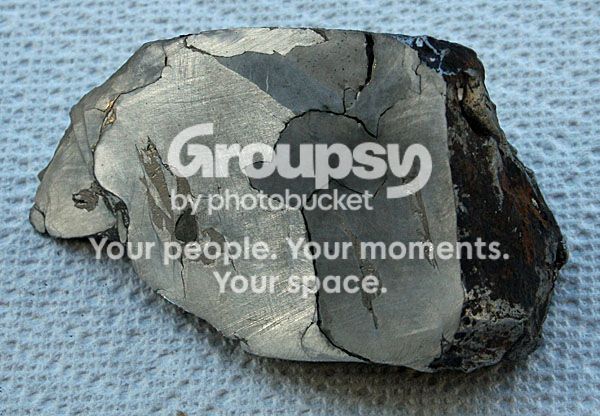

Here is an example of a freshly cut iron slice, it has not been sanded nor polished

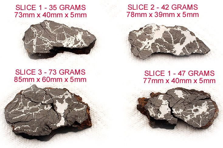

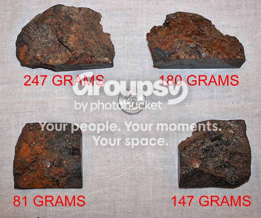

Here are some Canyon Diablo Graphite Nodule slices that I cut when I made my sphere, these are long gone but it's not every day you get to see a slice of a graphite nodule

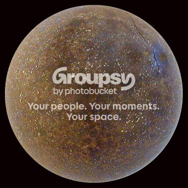

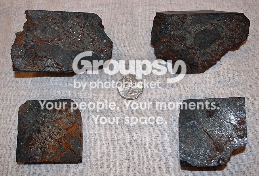

Bondoc Mesosiderite-B4 Meteorite – The Good & the Bad

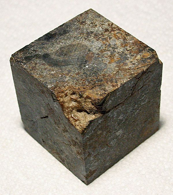

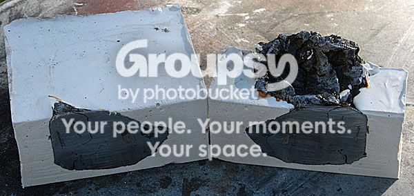

I received my Bondoc whole specimen yesterday and I processed it into my sphere rough cube today.
The GOOD – Very easy to cut
The BAD – not a lot of visible metal

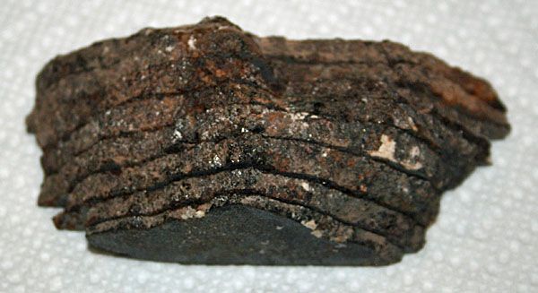

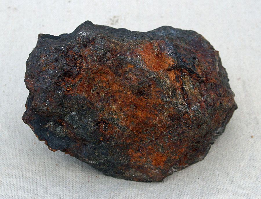

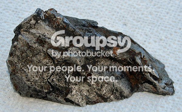

Here is a picture of the whole specimen
Here is a picture of it after cutting
Overall I will be happy to have a meso sphere in my collection, I just wish it had more metal in it.
I am soaking a small slice in phosphoric acid so we will see how that turns out
This is my first processed slice of the Bondoc B-4 Mesosiderite
It has an interesting look.
This piece is just over 1 3/4” wide and weighs 10 grams

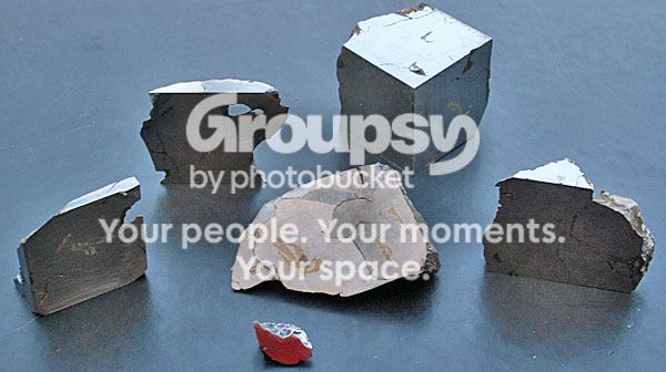

Question about Processing my Bondoc End Cuts
Because the focus of my collection is spheres I will admit that I don’t really know much about what other meteorite collectors like
I have started to process the smaller slices and end cuts of my Bondoc Mesosiderite by soaking them in phosphoric acid and then I polish them up to 400. I might go to 800 but I have to get some supplies to do that.
They end up looking like the 10 gram slice I posted above
I don’t mind risking the “value of the specimen” on these smaller pieces but I don’t know if I want to do that for these larger end cuts:
What do you all think?

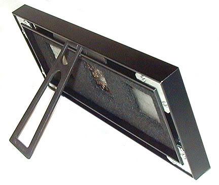

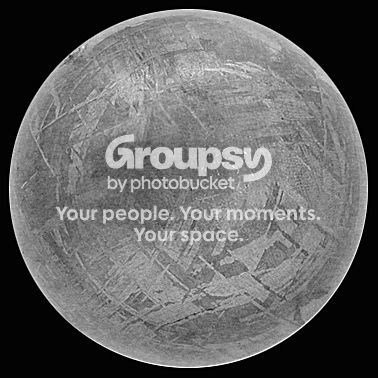

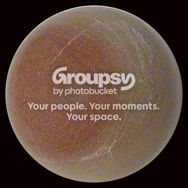

Today I re-etched my irons, normally I etch the Dronino (center iron) but it looked good polished so I left it
I also buil anew display board in anticipation of 3 new spheres I should be adding in the near future

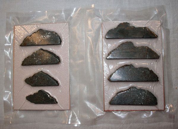

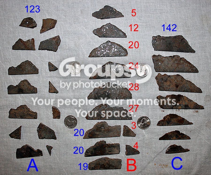

I’m selling some Bondoc Mesosiderite on another forum and one of their members took advantage of an opportunity to buy a set of slices cut from a single end cut that had a lot of visable metal.
He bought the slices in column B because he thought it was neat that they were cut from a single section
I set up this image for him to show the post cutting shape of the end cut
Here they are ready to be packed up for shipping
He opted to do the final polishing so I look forward to seeing how he is going to display these.

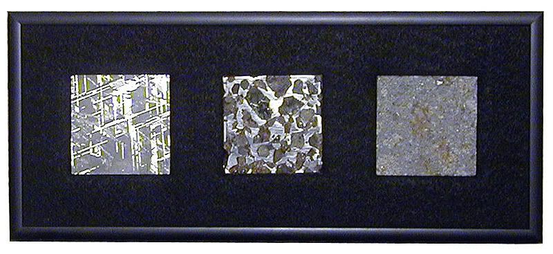

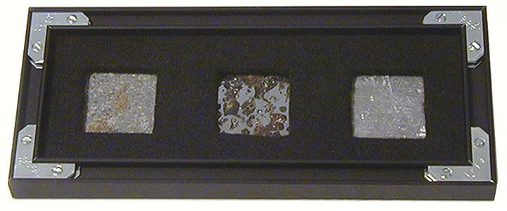

This is a 3 slice display I made when I used to make 50mm square slices to get a better understanding of what they would look like as a 50mm sphere and to figure out how to work them
I started to process a 2400 gram Sikhote Alin end cut
Here is a video of one of many cuts I made which yeilded a 443 gram end cut
This is what the 2 pieces looks like
Here is the 443 gram end cut that is 3.5 wide and 2.25” tall

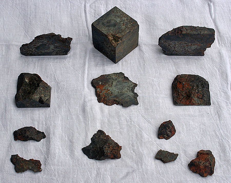

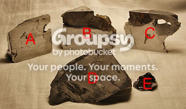

The initial process to turn the 2504 gram end cut into end cuts, slices and my sphere rough is complete
With my current work schedule it took about 5 days making one cut per day.
Here are some pics of the processed material
We ended up with the following
A – 262 gram end cut with 5 cut faces
B – 358 gram end cut with 3 cut faces
C – 163 gram end cut with 3 cut faces
D – 443 gram true end cut, single cut face, this is the nicest end cut of the lot
E – 14 gram fragment consisting of what looks like 2 crystals
My sphere rough weighs 1126 grams and Dmitry is going to earn his money if he gets a 50mm sphere for this rough because it is tight.
We had an initial cut loss of 138 grams or right around 5% so that’s good
