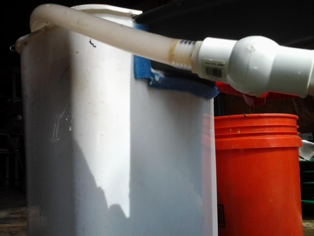

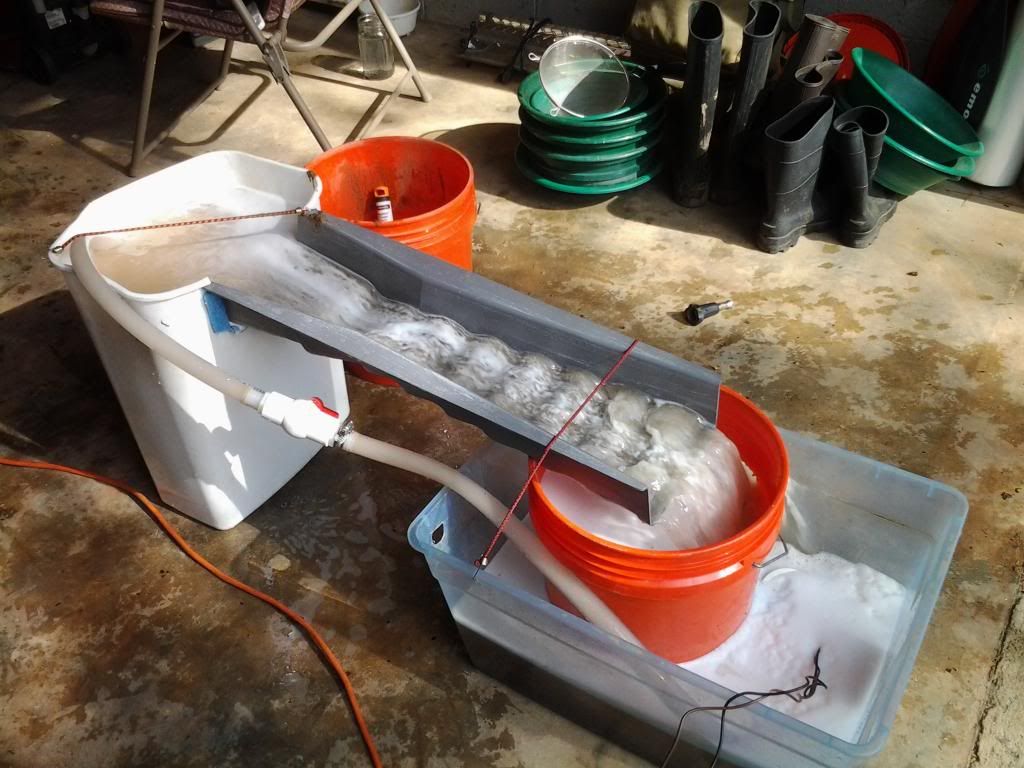

I saw this set -up on another site and changed a couple things to fit my needs and here it is. I am using a 800GPH bilge right now but think I am going to step it up to a 1200GPH for a little more flow.The blue foam that is sealing the flare into the trash can is cut from a pool noodle and works really great!It had only one small drip that wasn't even enough to warrant a bucket to catch it.I know the garage floor looks soaked but that is from me be excited and in a hurry and when I said "OK" my son turned on the hose,I wasn't ready but the water flowed anyway!LOL! The last pic if this downloads right is a video of it working(with to much jetdry....once again....I was excited!!!) so if anyone could give me feedback on how flow looks and if I am correct in needing a little more I would really appreciate it! I got this idea from ajpops on Eastern Prospectors site.....
Really cool, nice job keeping it cost effective too!

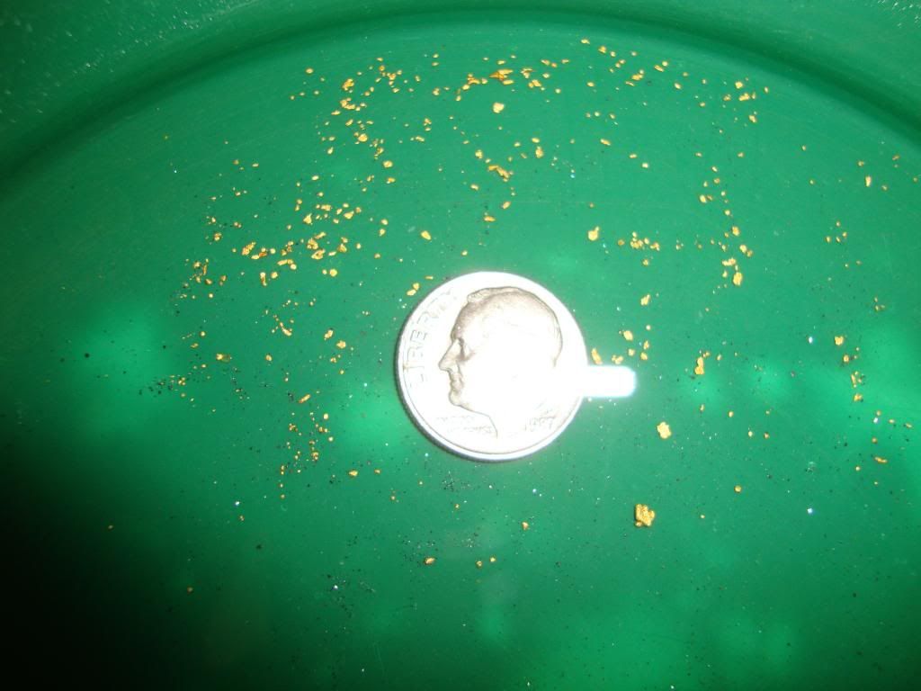

First half of my clean up using this set-up. Classified dirt down to -20 and run through CA Bucket Sluice and only found 3 little specks of flour gold so I am really happy with how well it worked!
