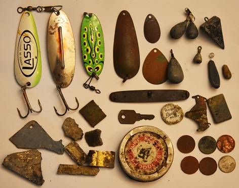

I spent an evening hunting an area along the North Sakatchewan River, which was at one time used as a snow dump, from ploughing heavy snow from roadways. I got the usual fishing tackle, some coins and aa few older relics as shown.

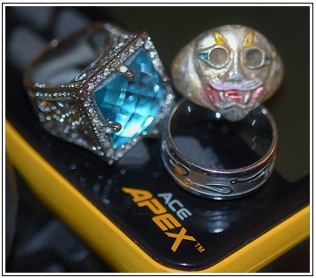

I love coin shooting, digging for jewelry, water detecting and finding older relics wherever I hunt. I did manage to get 3 rings......one in the woods and 2 in sports fields. All three rings gave off a nice clear signal, whith the coil going in all directions, which of course is why I decided to dig them. A soccer field gave up a nice butterfly brett and earrings
