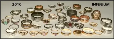

Very cool John! I'm curious to know about your best ring ever with the infinium. Do you still have it. If so, can we see a pic. Thanks! IGH.
Sorry, I misread best "year" ever[emoji12]. Congrats on one heck of a yr. Just wondering what was your best gold ring ever?
I started metal detecting in 1995, and the year I used the Infinium, was my best year up to 1907 as shown in the picture. I believe 2010 was my best ring year, using the Garrett Scorpion Gold detector, Infinium, Ace 250, Garrett Beach Hunter AT3 and the Garrett AT Pro.
