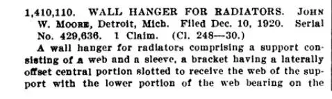

Here's more info about the item: Inventor: John W. Moore, Detroit, MI
