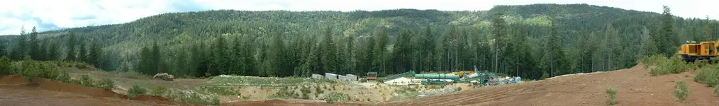

Yes, listen to your friend. Build the sluices into the system that's already there. Your wanting to put in a "Rag Plant" to be exact and we have a lot of them running over here in California. Pay attention to page 13, 14, 25, 26. I've seen them in operation here and have friends that still work on them. -----http://www.conservation.ca.gov/cgs/geologic_resources/gold/documents/sp87.pdf -----
You want to build it inline with the plant and if the plant uses water separation then they should already have one in place. This video gives you an idea but you're going to have a sluice 2 to 3 meters wide in order to keep up with the rest of the plant. Basically it sounds like your friend has a clue and he is familiar with the area you are in.
Depending on the amount of gold being recovered, there's plenty of equipment out there but you will need a mining engineer to design it for you unless you make some phone calls.
