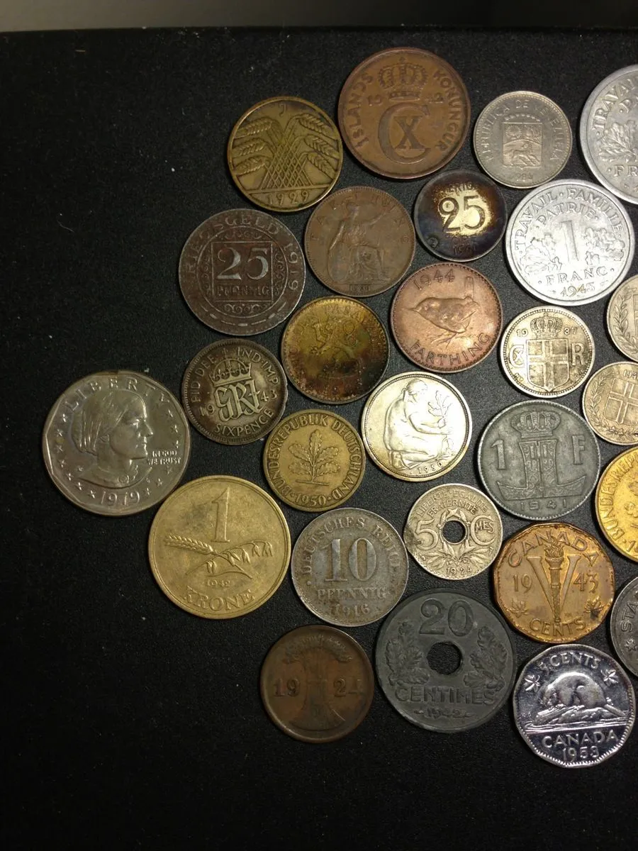

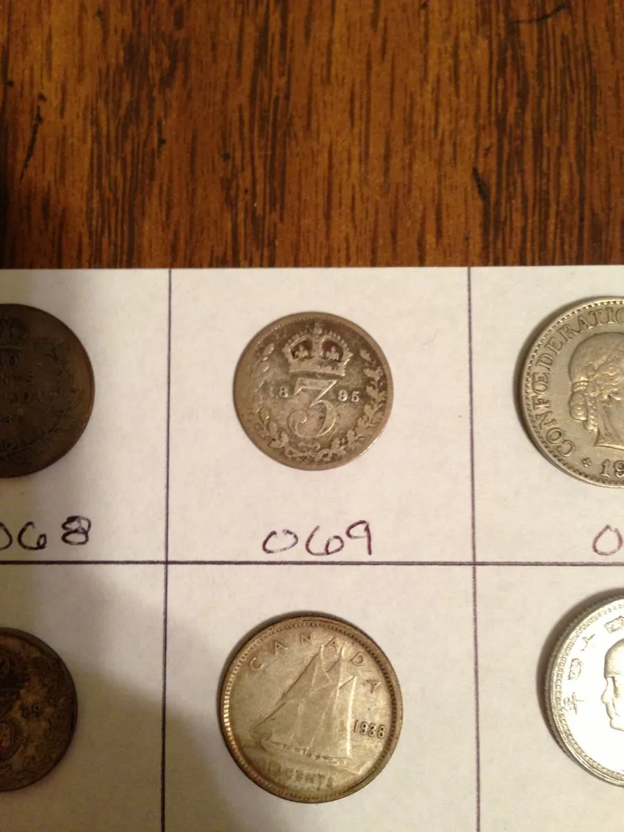

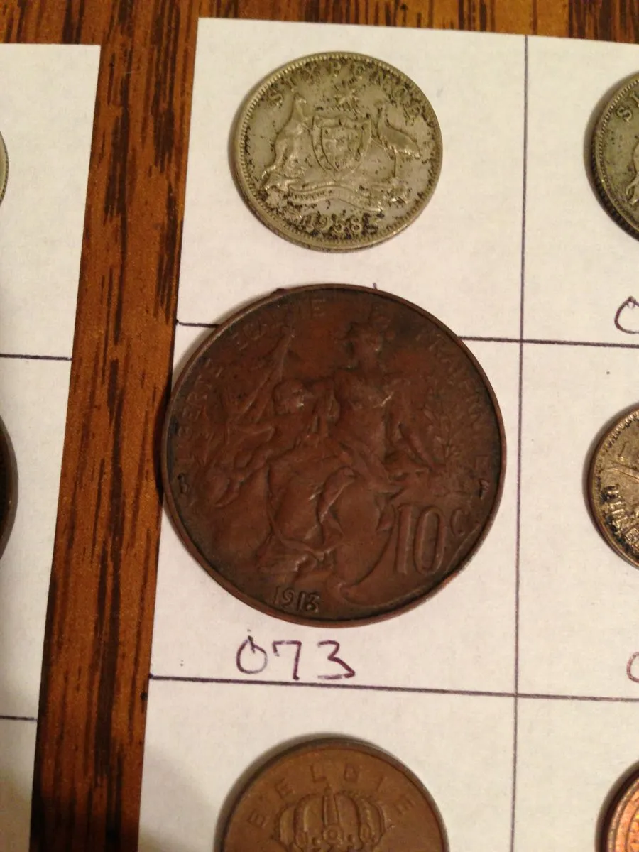

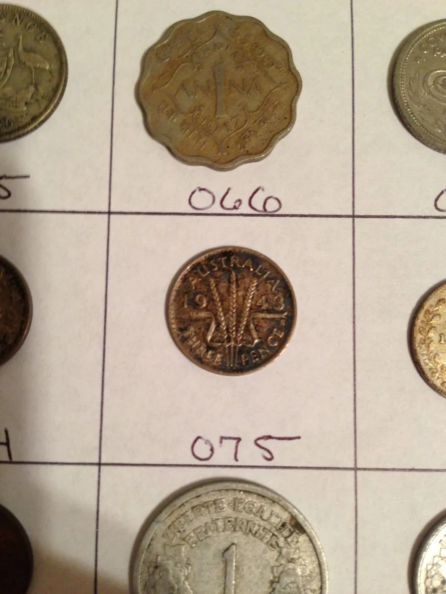

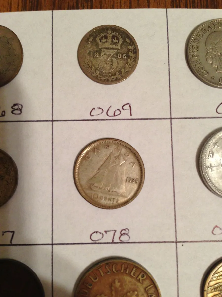

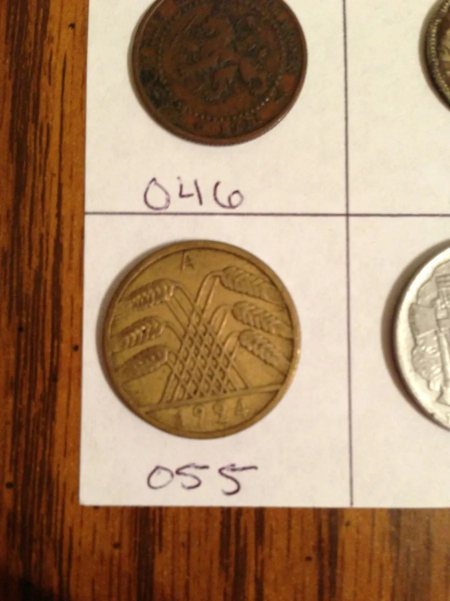

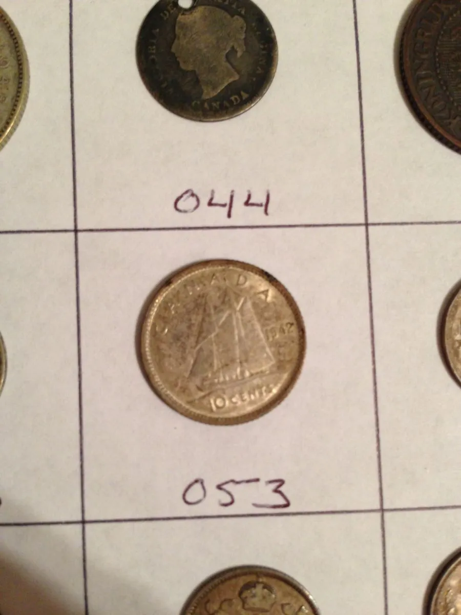

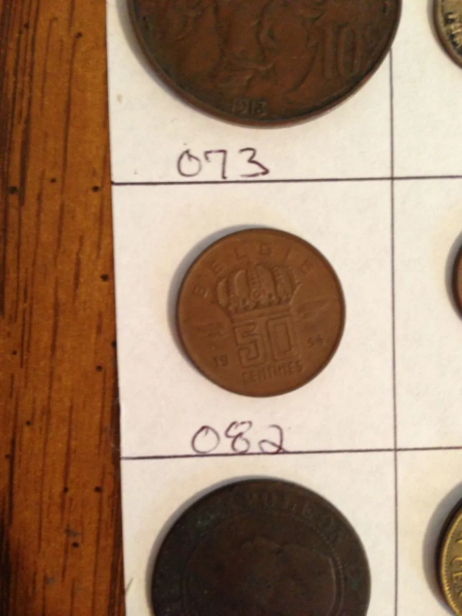

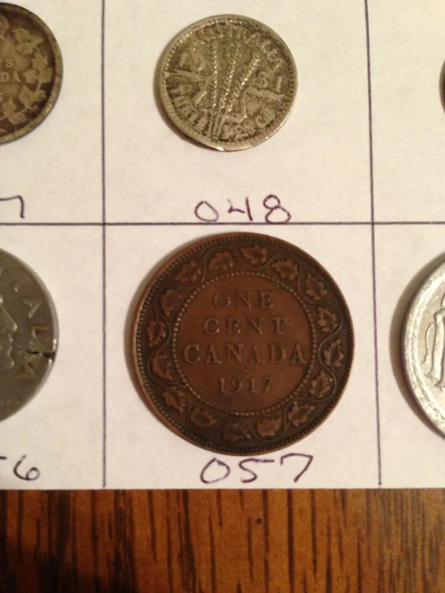

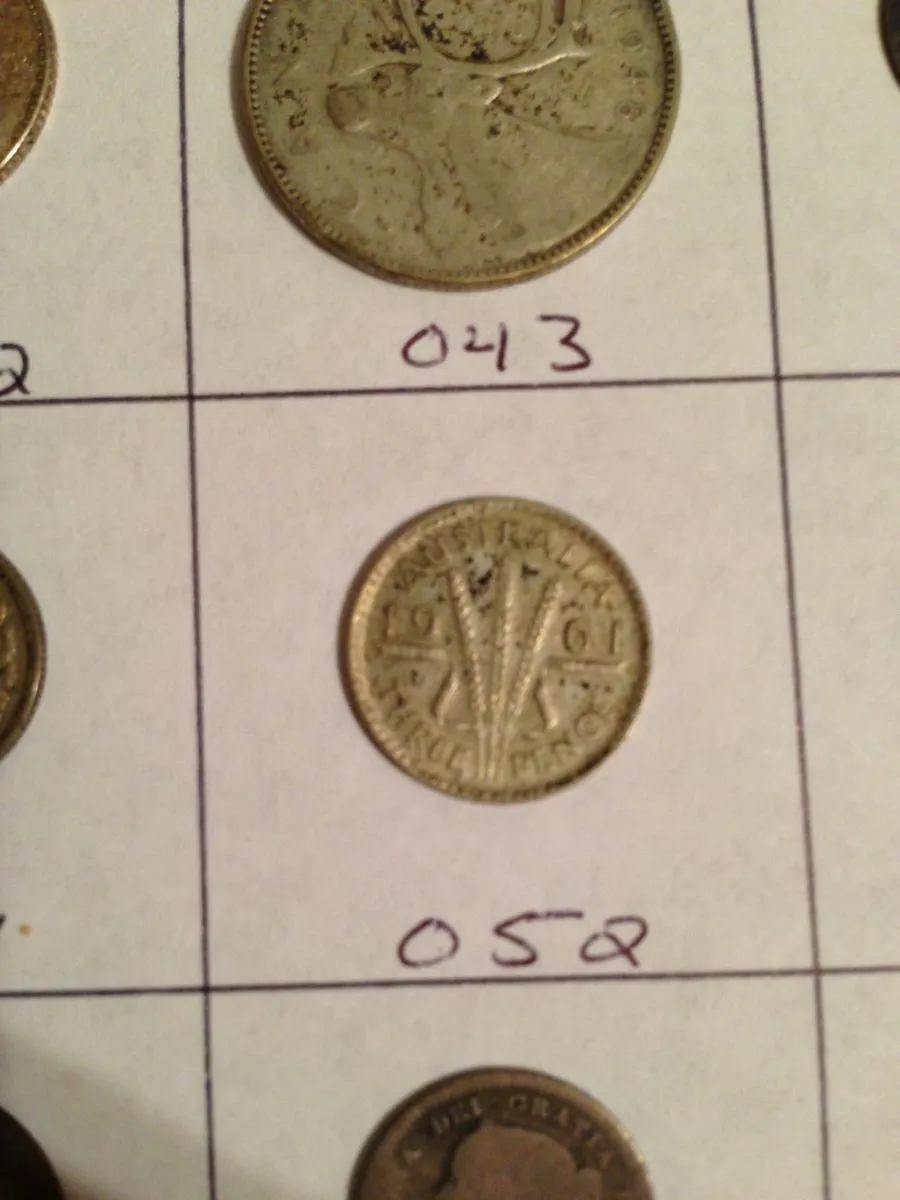

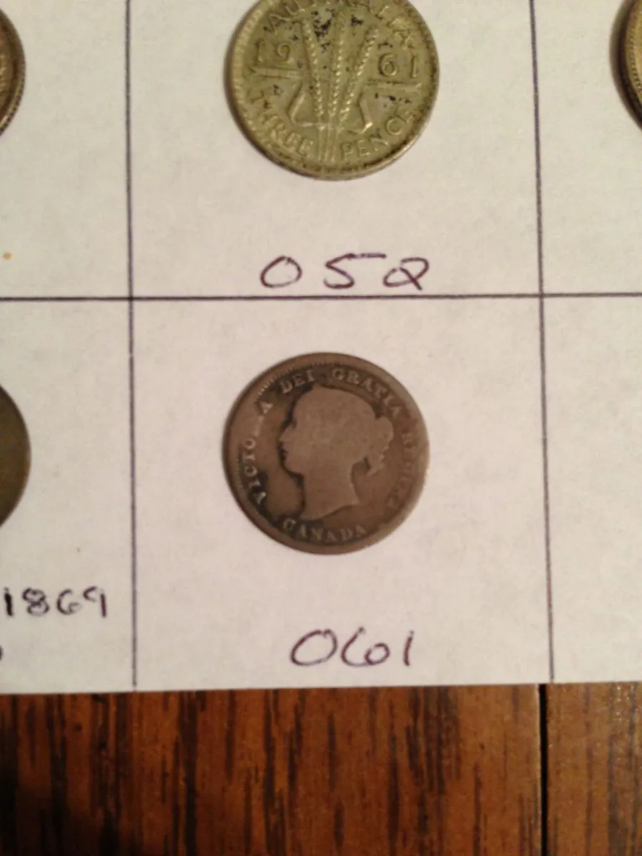

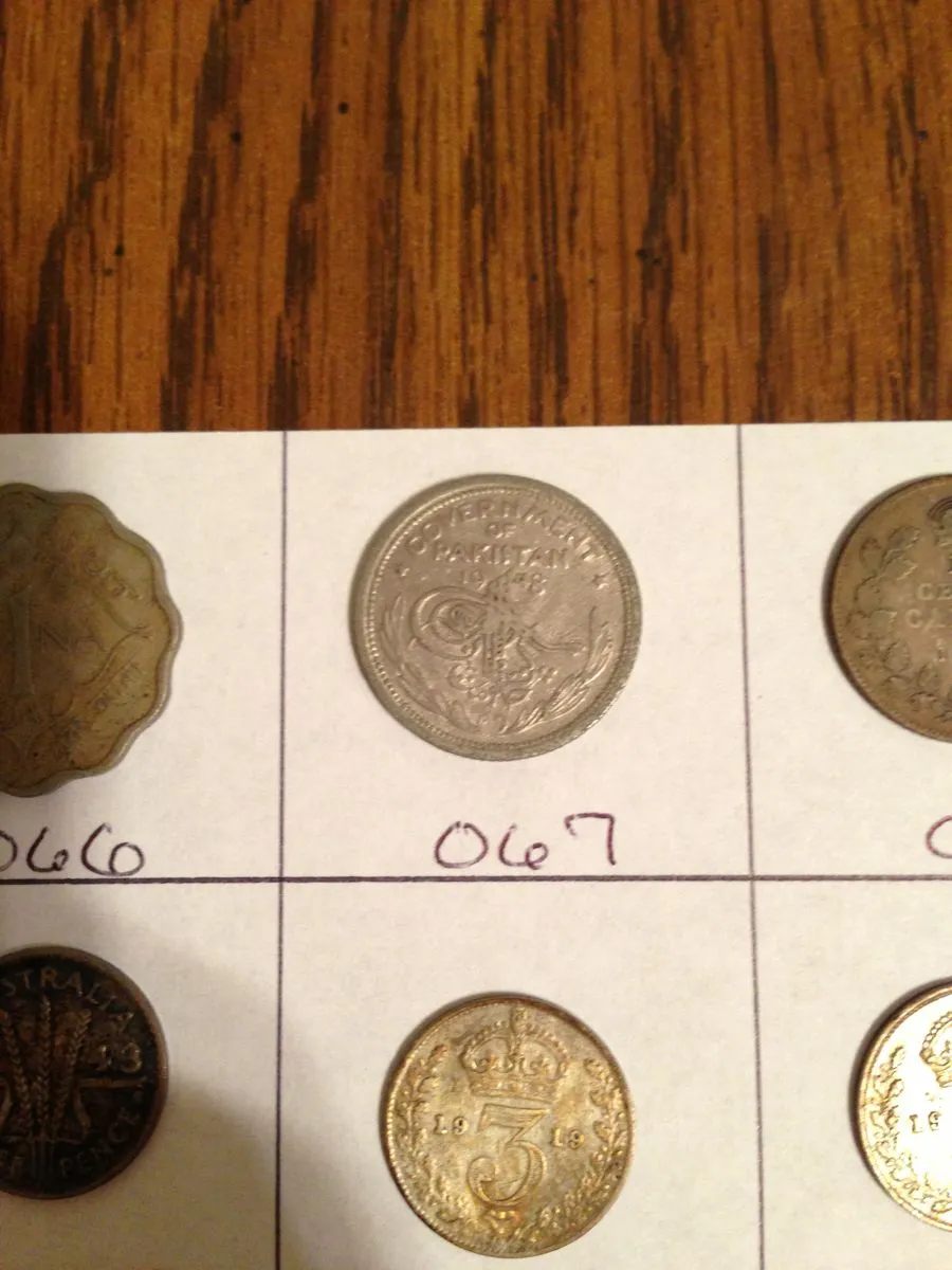

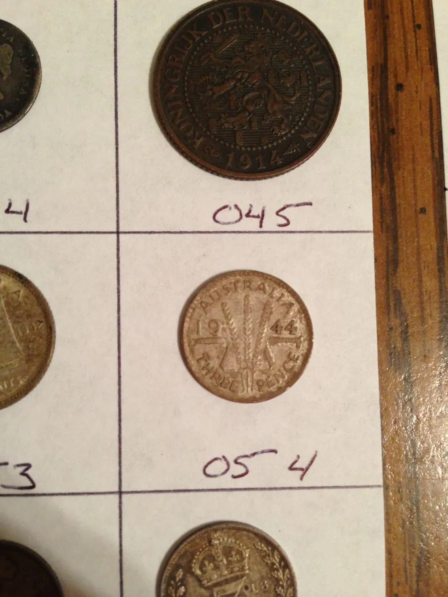

Here are some of the coins I tried to label all the coins so if you were go refer to one I would know what your taking about. Hopefully your able to help!

It seemed to be a bit from everywhere. I numbered them so It would be easier to Reference. I started at 1 and went past 300 not counting same date doubles and a jar full of wheats. I'm not to sure if I got them for a good price though.
Ok, I can help you with a few for now

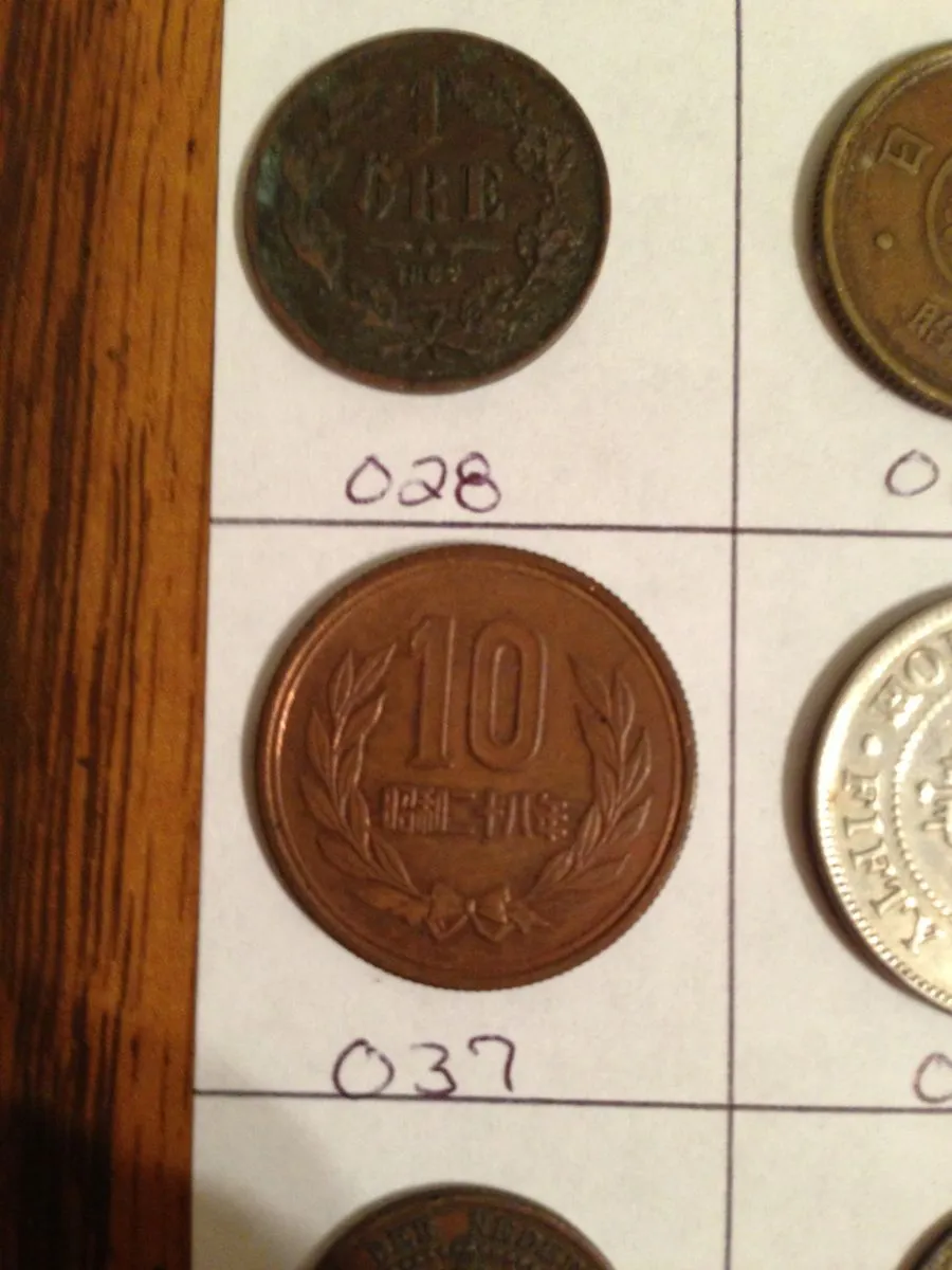

Number 37 is a 10 yen coin from Japan (no clue about the year)

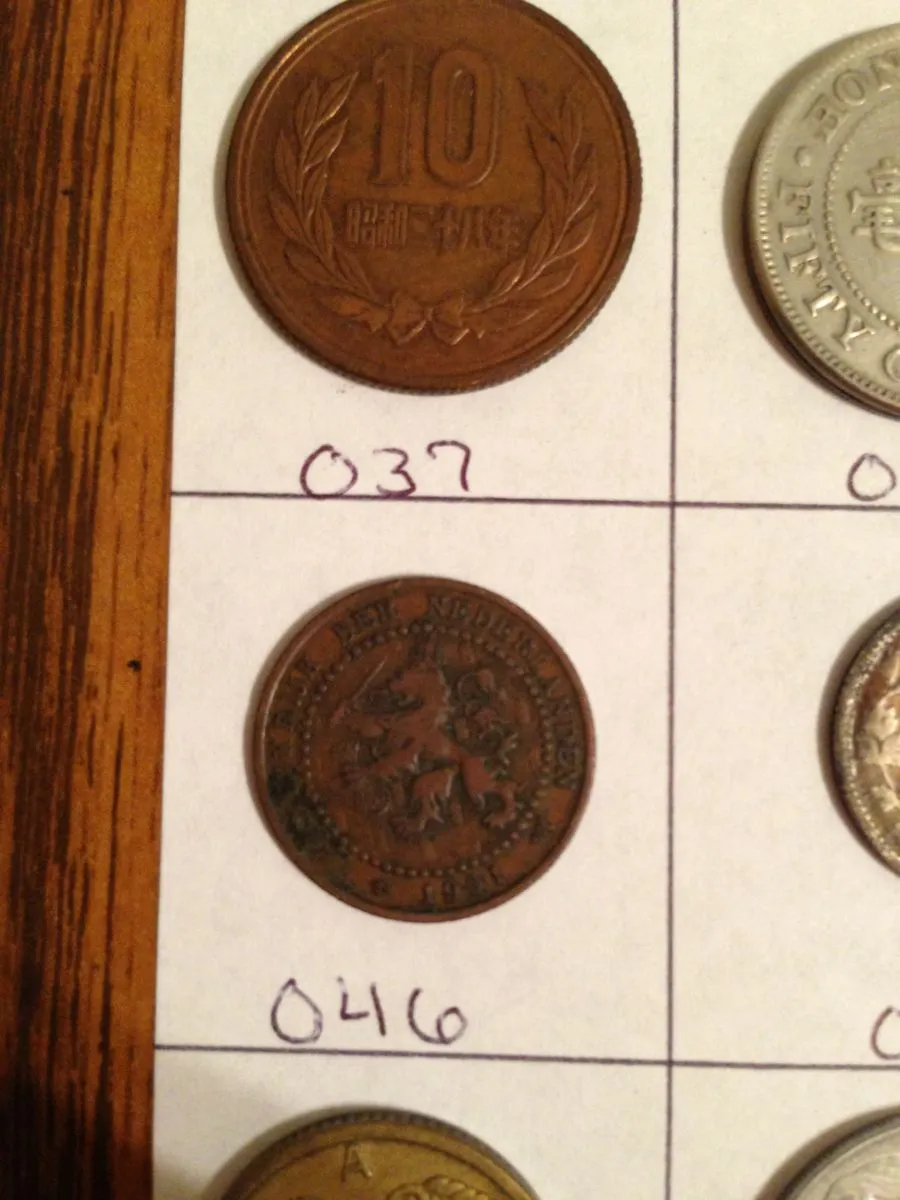

Number 46 is from the Netherlands I believe (can't make out the date)

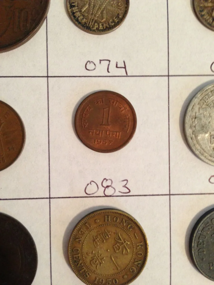

Number 83 looks to be a coin from India, 1 pice I think, a 1957 1 pice in your coins condition might fetch a buck or two on eBay
Number 82 is a 50 cent coin from Belgium, I think yours is dated 1954, if so it is common and one recently sold for a quarter on eBay
Number 89 is a British halfpenny, it is a common year and is worth a few cents to a buck or so (most George VI 1/2ds aren't worth too much)
Number 98 is a Dutch 1 cent from 1900, worth a dollar at the most
Number 81 is a British 50% silver threepence, I think most acorn 3ds are just worth melt, except for the 1928 and 1930 issues which are worth a modest premium in circulated grades (about $5 for the 1928 and about $3 for the 1930 or so)

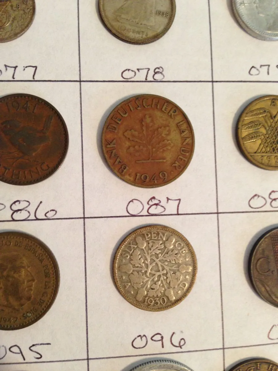

Number 96 is a 1930 sixpence (British, 50% silver) just worth melt
Number 78 looks to be a Canadian dime dated 1938 which is just worth melt (80% silver)
Number 86 is a 1941 farthing which is very common, worth just a couple of cents
Number 49 is a 1936 New Zealand threepence which is 50% silver, a common date, and just worth melt
Number 48 is an Australian threepence, although I cannot make out the date, to me it looks like 1931 (which is impossible since now Australian 3ds were minted bearing that date) or 1934 (which had a different design). However, it is silver and the value depends on what date it is (looks like it might be from the 1960s)
Number 50 is an Australian threepence (50% silver) worth a couple of bucks (worth more than bullion but not much)
Number 41 is a 1939 Canadian dime (80% silver) that is a better date and worth about $6 or so
Number 51 looks to be a 1936 10 cent coin from the Netherlands, it is silver and worth about melt
Number 52 is a 1961 Australian threepence (50% silver) it is a common date worth about a buck or two
Number 43 is a 1946 Canadian quarter (80% silver) and is a common date worth melt
Number 44 is a sterling Canadian 5 cent (half dime) '
Number 53 is a 80% silver Canadian dime dated 1942 worth about melt
Number 54 is an australian 50% silver threepence 1944-S worth about melt
Number 47 is a Canadian dime dated 1905 (it is sterling) and is worth about $5
Number 60 looks to be a Netherlands 10 cent coin from 1869, it is worth about $8-10 or so
Number 63 is a British sterling threepence dated 1916, it is a common date worth not much more than melt
It is a 1951.
