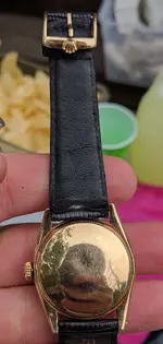

Hey Everyone,
I need help now.....I can buy this watch now for $1800. Saw the woman sold a few other things super cheap.
My only concerns:
- movement seems to tick and not be smooth
- where the medal pieces go into the watch, on the one side, the holes go all the way through.
Does this look legit? Worth it?
bill
I thought they all had sweeping second hands? (even good fakes ;D )
chub
I'm no expert but it looks like a legit Rolex from the 1950's or so to me. Are they making knockoffs of the old ones? The strap, I'm no so sure of, need better pics. Check the clasp for marks.You need to get the back off of it too.
If it were me and I didn't have the knowledge to discern whether it was authentic or not, I would ask her to meet at a jeweler together and have it authenticated. You are spending $1800 after all. It's not a crazy request. Just don't discuss value in front of the jeweler when it turns out to be real cause if it is, $1800 is a steal!
It definitely needs a good servicing and cleaning.

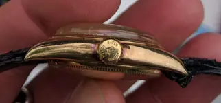

So, I bought a couple others things from her at great prices, was well ahead, and decided to take a chance. I just got the back off using rolled up duct tape.
The case is gold and I assume fakes of this model are few and far between, but the serial numbers are not really making sense.
Back of case: 6084
Movement: F 49660 & 19507
Going to do some more research. If anyone has any tips, let me know. Lady said I could take it back if something turned out bad.
I'd say it's legit. Looks like one i sold for parts. Not gold though. Nice find!!
Totally legit reference 6084 although it is clearly a redial. Still a good buy at $1800. I suspect she was offered $800 to $1200 for it by a dealer and is trying to get more. Will need a service which can be as much as $800. I paid $1200 for my 1954 reference 6085 in stainless and it also was a redial but a much better executed one.

@Jim....I'm new to watches. Why do you think it is a redial and what makes it a bad one? The hands look different than other models I've seen, but they look old. Also, to my untrained eye, the face also looks original and not touched up.

It's a redial because the font is really messy looking. Even for being how old it is Rolex font was really good even then. Looks like an amateur redid it with a pen...... I'd keep it only because of the dial, I'd probably get it redialed again. Vintage Rolex collectors are very very picky with redials. Someone may look to redial it again so it looks better. Still a good price at $1,800 though
Here is a thread with some real Rolex dials, no redials. You can see a major difference in font. https://omegaforums.net/threads/real-dial-or-a-redial-of-this-1950s-rolex.22676/
Maybe I'm missing something, but I'm not seeing a redial on it. :dontknow: That old spotting also leads me to believe that dial has never been messed with.
It's just an old redial. I have a longines watch that had been re dialed a long time ago and looks original with patina but ultimately it's still a re dial. They were very common, some better than others. But still they really hurt the collector value a substantial amount.

It may be the original dial but the printing might have been updated and done poorly. The spacing is all wrong. It does look like it was written in with a fine pen. Don't be discouraged. The value is in the case and movement. IMO. If it runs I'd value it around $2300-$2500.
Well I guess if your one Longines is enough for you to make that assumption, then I guess you should know.
Yea the whole idea i was getting at is that just because the dial has spotting/patina never rules out a redial. Same goes for my Longines. Not saying i can tell because of the font on my Longines. The dial itself is probably original but the font was replaced sometime. They strip the font off and redo it for any number of reasons. I agree with Jimdons valuation as well expect something in the two thousand range. More towards $2500 end. This would be a great Rolex for an entry level collector.

IDK:dontknow: I've had only 3 wristwatch's redailed...I'm just not seeing fonts altered, things done with a pen, but I don't know everything. I see true age in the hands, spotted dial, coloration of the hour chapters and darkening of the radium. Guess I've never seen a redial look that aged before. Overall it's a great find in its current condition and thank you for bringing your observations to my attention.
Thanks Jim and Spartcom5 for the info! I'd be lying if I were to say I wasn't a bit disappointed. However, it has been a great learning experience, which will continue as I figure out what to do with it. It runs....so that is promising.
I'm going to bring it to a couple local watch shops and see what they say. I like the watch, but don't love it. Not sure it's worth dropping the cash to get it redialed/ serviced. If I were to get it serviced / redial would you recommend a reputable/skilled shop or Rolex?
Not Rolex!! A good local watchmaker should be able to service it under $600. I've seen it go as low as $285 to service a working watch. I believe the Rolex dealer service rate starts at $600. Parts are extra if needed.
