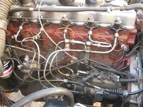

An online friend need to identify this 4cyl diesel engine.
Can anyone ID it for us?

Real long shot - Isuzu made a 4-cylinder diesel called an "X20". Just a guess.
Side note - that Fram fuel filter also fits Volvo and Pugeot diesels

Looks like a Kubota motor , not sure as I can not see the the details on the engine .
They make tractors with those type of engine's .

Back to the original engine.. I would go with Isuzu 4cyl. Maybe a BD or BG series. There are some clues to be had from the photo. Clutch would indicate automotive application, but could include forklift. It has heater hoses, so again automotive. Auxillary belt-driven pump could be power steer. ....But...
There are 2 clues that indicate to me that this is a re-power. It has been fitted with a remote engine oil filter. See the hoses coming off the engine block and laying at the back of the engine..then into a crudely adapted oil filter base. Means the stock filter location did not suit the new application. Ditto for the hose coming off the oil pressure adapter on the flywheel housing.
Hope this is of some help and makes up for the hijack :)
John

The pic shows a similar engine....appears to be Land Rover maybe.
http://img.youtube.com/vi/IoH2WA7ilqw/0.jpg
Tnx Keith, it appears that's it!
..and I enjoy the vid of the TD-18 !
Hi rm... Glad you enjoyed the video :icon_thumright:
The photo supplied by kieth (sp) is of a 5 cylinder engine. Yours is a 4 cylinder, plus there are many more differences visible between the two.
Could not find an exact match but the one i posted has alot ofthe same features. The injectors & pump location & type are very similar but look like a later model.

The diesel pictured doesn't look domestic to me. Looks european or maybe asian. Kubota is a possibility. I have three kubota 3 cylinder diesel engines but none have close similarities to these (engine makers often use the same oil cap, or injector pump, or other items on several different engines). I was a car mechanic for years but this one doesn't ring a bell with me.
Just my input, which isn't much help.
