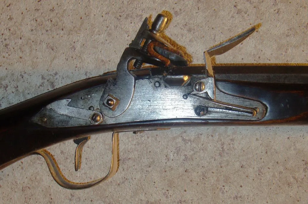

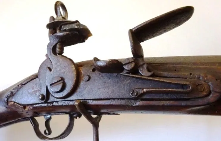

Btw... I forgot to post this last night...
This is as close as I got...
AARC, due to the extra screw hole, that's what I'm thinking also.
Just saying some times people would drill more holes to secure the plate better. Just keep this in the back of your mind sometimes people made modifications to things that might be different then ther original makers

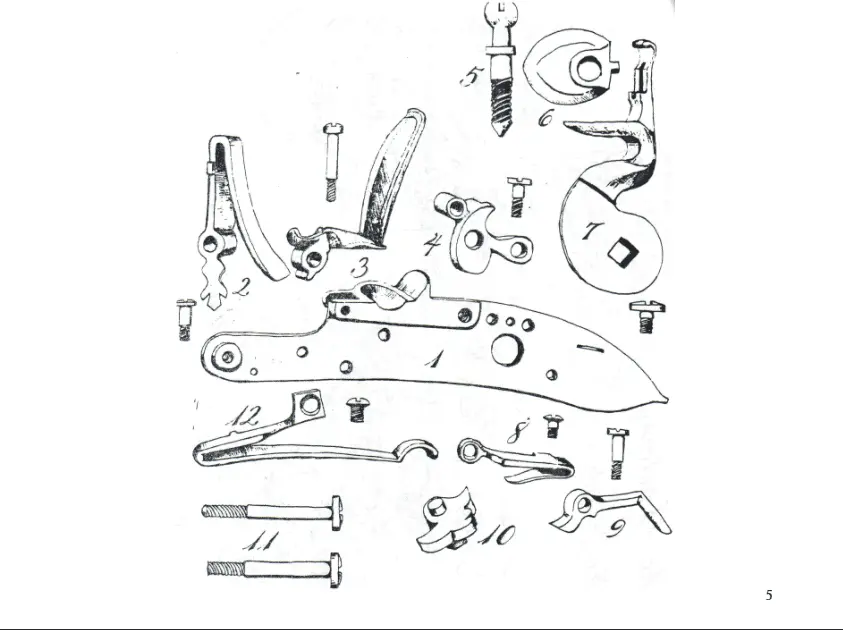

Most of the holes will be for attaching the inner workings. In this image the furthest hole to the left of the lockplate ("1") is for the forward lockplate bolt and the uppermost to the right of the pan is for the rear lockplate bolt (bolts are item 11). Two was typical and hood sized (3/16" to 1/4" dia) bolts. You can see they "beef up" the lockplate for those bolts. Lots of parts to the mechanism mean lots of holes
The sideplate is on the other side of the stock to reinforce the wood when it's all bolted together.
