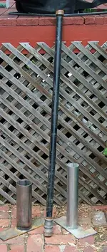

When portability and weight are an issue I use a ramrod and tube for sampling.....
