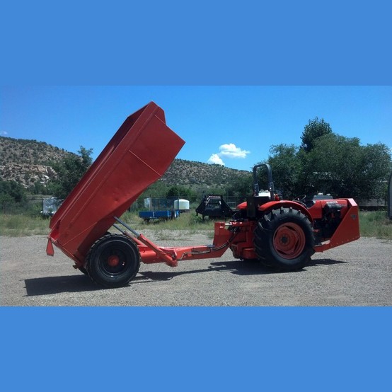

Those little Sherpas are very cool, but also very expensive for what they are. They're like the miniature offspring of a JCI 50M mini-LHD. Like a JCI 50M, they'll be pretty tippy, especially on rough ground. If they were $4,000 used as opposed to $25,000, they'd be a bit more interesting but there are better options in that price range.
CAVOs and other overshot machines are indeed wild, and their compressed air requirements are hefty to say the least (600 CFM for an EIMCO 630). They also require a bull hose for air, so forget about long trams - that machine won't go far from the face without putting in some effort swapping hoses. Pretty easy to run over your hose if you're not careful. If you're serious about avoiding track, your only pneumatic options are a CAVO or EIMCO 630 crawler mucker. 630s are neat little machines, though they require 11' of vertical clearance to dump at minimum, and I wouldn't be surprised if you'd still smack your bucket lip on the back since they're designed to rock backwards when dumping to help empty the bucket. They're roughly 5' wide, and you'll want some clearance on either side so you don't scrape yourself off on a rib. If you'd like track, I have a friend in Fresno with more rail and cars than you can shake a stick at for cheap, plus a battery trammer (in need of batteries), and can pick you out an EIMCO overshot in 24" or 36" gauge this weekend.
No matter what you do - battery equipment, trailing cable equipment, or diesel - you'll need a genset on site if you get away from pneumatic equipment, and a big compressor if you don't. There's not really any getting away from a big diesel plant of some variety topside, so pick your poison: jumpy pneumatic equipment, expensive and small battery equipment, or running vent bags and a bigger fan.
Personally, I'm 100% on diesel for loading and haulage. If you can track down a machine with a purpose-built underground engine, its emissions will be much cleaner than anything built to run on the surface. I'm partial to small Deutz diesels - 6000 CFM at the face will be plenty. I have these little guys:
First machine is a 1983 EIMCO 911B, second is a 1977 5-ton Young Buggy. I bought both machines for less than a new Sherpa 100 ECO. Honestly, if you can find an EIMCO 911 in good repair for $20,000 or less, buy it and accept the ventilation requirements. So long as you keep the hydraulic and fuel systems clean, they'll run circles around skid-steers and all the ultracompact/mini equipment. They're a little bit "over-bucketed" like most LHDs so getting a full bucket takes finesse, but each full bucket is 1.5 tons of quartz vein material and you can head for the portal at a jogging pace. Low center of gravity too, so not tippy. Biggest things are clean/quality fluids and keeping your cooling system happy and clean.

Sounds like you are planning on something pretty big if you are considering C10 suspension. I've never crawled under a normet, rhino, or getman but I don't think they have much if any suspension.
How many yards/ tons are you thinking of hauling per trip? No concern about 4 wheel drive?
Other than 40-ton articulated surface haul trucks, no piece of mining equipment I've run has traditional suspension. I'd suggest an air ride seat in lieu of suspension, coupled with aggressively cleaning your haul road. Combine reasonable speeds with an air ride seat and you'll be comfortable.
What you're designing sounds like a 2-ton Young Buggy, down to being built off pickup parts.
Yea I'd love a 911B and a Young buggy or two. Problem is the fact that it is very rare to find anything that isn't an overpriced pile of clapped out scrap metal that someone thinks is worth top dollar because of gold prices.
I know where quite a bit of stuff is sitting rusting away because the owner won't negotiate reasonable prices hence the search, evaluation, and modification of other equipment to see if it will work.
Then comes the availability of parts of older equipment. Most of the smaller stuff hasn't been made in many, many tears.
The future of mining is shifting to smaller mines and backnto narrow vein mining. Large discoveries are exceedingly rare anymore. If small mining equipment pops up and is priced right, I'll happily look at it.

No problem! If you need a 911, I know of a 4-cylinder one for sale in northern California. The owner says it needs new tires, which are usually about $250 each. The 4-cylinder EIMCOs are 6" wider to accommodate the extra cylinder; the main difference is tramming speed (7.5 mph versus 5 mph). EIMCO's specs show breakout force to be identical between the 3-cylinder and 4-cylinder machines.

No, it wouldn't, but you'd take a payload hit with battery weight. Once you go articulated, you're in a very different class from a Young Buggy. The all-terrain capability of that truck in the video speaks for itself! It does lose out on payload - looks like they're good for about a ton at a time. There aren't a whole lot of small articulated trucks out there; the only others I've found are Getman 5TAs ($35,000 each and needed work), a few Elmacs (around $100,000 each - virtually nobody who has an Elmac will let it go for cheap!), and some contraption cobbled together from a Kubota tractor and shop-built rear frame and dump bed:
I'd track down a small hydrostatic transmission or motor (maybe from a telehandler? It works for YMC!) and go from there if I were designing it from the ground up. As in our last conversation, I agree that hydrostatics are the way to go for small equipment that will be operated in tight and/or steep areas. On top of dynamic braking and low inertia, remotely mounting a motor opens up some interesting layout options like on a 911.
