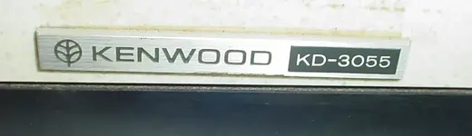

This is why I don't usually buy electronics. If this turntable were in good working order, I would probably get at least $150 for it. I paid $32.50. It turns on but the table doesn't spin. I'm hoping I can get $50 for it as a parts piece.

The turn table mite not need more then a rubber drive belt,,well worth checking.
Darn you guys both beat me too it. I will say that in my experience those belts are usually easy to access and remove/replace, if you are so inclined and the fit isn't terrible you might try swapping in one of those big blue produce rubber bands to see if that's actually the problem before procuring a replacement belt. I had reasonable success with those on a couple of turntables in the past but ymmv.
Thanks for the belt replacement advice. I keep forgetting that YouTube has all those "how to" videos. I pulled the platter to check the belt and it is, in fact, missing. I turned the machine on to make sure the motor works. It does. Then I noticed drive post on the motor seemed rough. Closer inspection revealed this:
It looks like at some point in the distant past the drive belt broke and wrapped itself around the post. Then the turntable sat idle for years and the belt petrified into this mess. I'm sure that can be cleaned up but it won't be the two minute job I was hoping for. Sigh...
