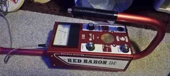

I JUST AQUIRED A RED BARRON BOUNTY HUNTER VLF STD THAT I'M TOLD IS FROM THE 1970S. IT HAD ISSUES WHEN ACQUIRED, AND I WAS ABLE TO RECOVER A FEW OF THEM. 2: BEING THE POTENTIOMETERS WERE FROSE UP. I REMOVED THEM AND WAS ABLE TO CLEAN THEM UP AS WELL AS REPAIR THE ANALOG DISPLAY WHERE THE NEEDAL WAS STICKING. HAD TO REMOVE THE OLD STICKER FROM THE DISPLAY THAT HAD EXPANED DUE TO WATER. PRINTED A NEW ONE AND INSTALLED, BY EXAMING THE OUTSIDE IT APPERIES, IT GOT WET A LITTLE WET.
I need a manual. I KNOW THIS IS A LOT TO ASK, BEING OLD, BUT I THOUGHT I WOULD TRY HERE.
