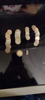

I don't have any experience with concentric coils, so I can't speak to the experience of switch from one of those to a DD. But I do have experience with pinpointing. My previous machine was an ATMax, and I ALWAYS had trouble figuring out how big to make the plug.
When I started with the Simplex, it took a bit of trial and error to narrow down the sweet spot on the coil, which, in my case at least, seems to be about an inch to 3 inches up from the center of the coil, depending on target size. Now, with a couple exceptions, I've been able to center in on it really consistently. More so than with the Nox 800, even!
As for nickels, I'm not sure where you heard it has trouble with them. Before everything shut down, I hit up a local elementary school, and was pulling out nicks left and right; they always rang up as a 25/26.
