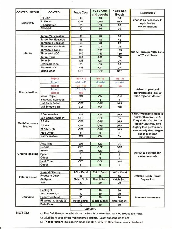

Most of the finds in the park were 3-5 inches. Some were almost surface. Hey, I found a forum that is just for V3's and I found a jpg with some really good tweeks for the V3 programs. I am attaching it, do want the link to the forum? I can't wait to try them. Maybe it will fix the gold/pulltab issue???

Link please and thank you.
The pull tab\gold rings dilemma is a problem with any detector since pull tabs ring up nicely at about the same as a piece of gold jewelry depending on the composition of the gold. I have a 14k gold ring that shares a VDI with pull tabs. That's where the human and machine need to be in harmony with each other. Sounds, visuals, etc all play into whether or not to dig. That is one reason I like the V3 since for me I can have ore options to figure out what the heck I might be looking at. I am not in harmony with it yet. More and more you will get to where things you struggle with now will become second nature. Same for me.
