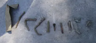

Got a chance to test drive my new toys today for the first time. Here were my finds (city lot back yard):
I won't be retiring today on this lot (LOL), but both the 300 and the carrot do work!
