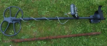

have just got my MK II
just made some tests yet, but This amazing result is
I'm going to spend a few days at the beach, with ..........MK II   .webpMK II    - Copie.webp

just a few outings with the MKII
but yes, the depth is there
