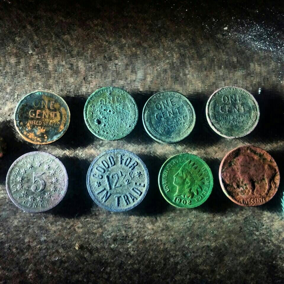

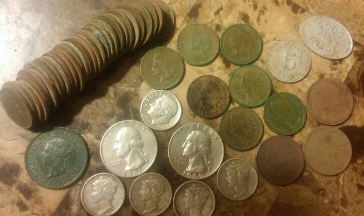

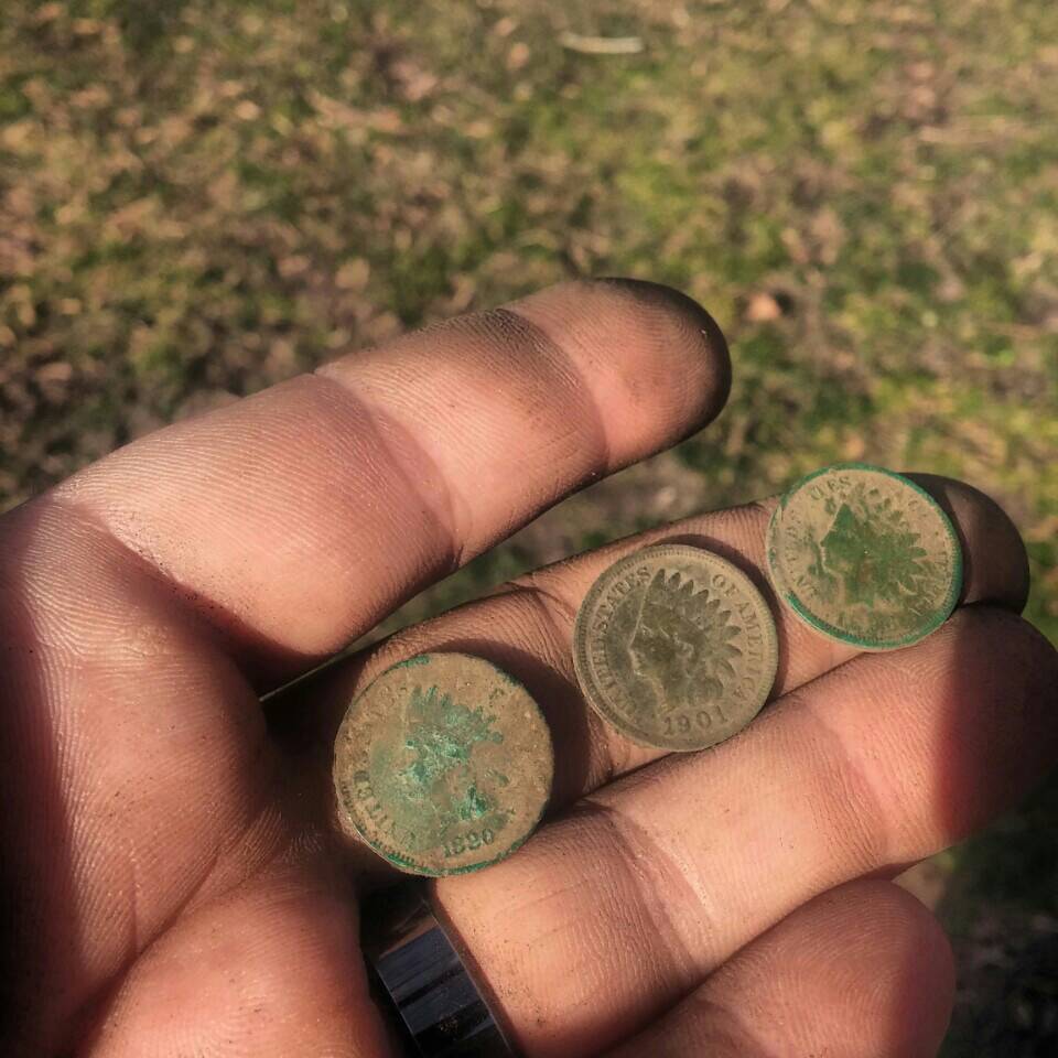

at 11 or 18 hits gold harder and small chains. also higher u go V and sheild and IDs pop.. I sniffed out all my goodies using 4 and 8 re working the area @ higher freqs
that was my small park last year
this year so far @ higher freq
