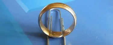

Ron, You are always finding great stuff, and certainly a lot more than I have found this year...... I appreciate your posts and figured you had a edge of some sort over your competition, which isn't me since I live on the east coast. What would you estimate to be the deepest gold ring you have found? For me, my Whites dual field may have a repeatable signal on a 5g, 14k gold ring at about 11". It is a faint but repeatable signal that I might or might not notice. At about 9" - 10" the signal is very clear.
