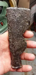

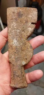

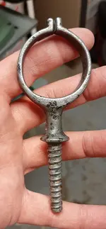

The title says it, all of my farm permissions are planted and its too darn hot here to entice me to detect the tot lots. :laughing7: So last week I decided to tumble the Plumb Hatchet and a few other interesting iron relics. These relics tumbled in aquarium gravel, 1tbp dish soap and a half cup of Lake Ontario beach sand. I tumbled them for 72hrs changing the mixture every 24hrs, then tumbling them for another 48 hours minus the sand.
Here are the before and after pics.

I use the Lortone 45c with a rubber drum, I then apply Conservators Wax to all the brass and iron relics, otherwise the finish looks dull and flat without it. It's difficult to know what to do with the more interesting iron relics that we find, I find that tumbling them helps to remove the rust and makes them more of a conversation piece. The iron surface of the other relics came out looking very clean, this is due to the abrasive action of the sand mixed with the stones in the tumbler.
I have a feeling the quality and hardness of the iron the axe is made from is much better than the other relics. Consequently, if I wanted to clean it down to the bare metal, I'd have to take a grinder wheel to it and I'm not interested in making it look new. The only reason I have time to tumble these pieces continuously for 5 days, is because I don't have a paying job to go to every morning. I?ve recently accepted a job with Generac Power Systems, which I'm now scheduled to start on August 9.
