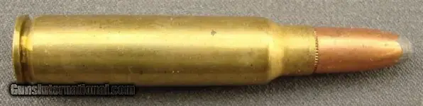

Found this in a public park
Marked 300 cal peters
From what I can find. Peters was an ammo company in ohio from 1860's -1940's
Any guess on an age of this?

Looks like a "belted magnum" - the belt on the body of the shell above the rim, which really did nothing for the cartridge - the gun manufactures thought that a "belted magnum" would be a good sale pitch......sounds pretty bada** I guess.
The only 2 calibers I can think of off the top of my head, that are .300 belted, are the 300 Winchester Magnum and 300 Weatherby Magnum - search those two guns and you will find your answer.

I don't think it's belted. I think it's headspace separated. My better-than-a-guess would be the .300 Savage. The Savage 99 has a rear locking action that would do that after a few hot reloads.
Probably one of the better rifle/cartridge whitetail deer combinations ever. Introduced in 1920, and by the mid 1950's the .308 Winchester/.308 NATO (based on this round) left it in the dust for sales and Savage dropped it.
Are you sure that the headstamp says CAL 300? From the pic it looks like a degraded SAV 300. Peters sold both belted and standard 300 Savage rounds.

Looking closely again at it I think you are right
Definitely could say sav. When would that date it?
Sometime after 1920 to the mid 1960's. After that it would have said ".300SAV"
When was it fired? That's a better question. I'm shooting 1944 Greek ammo in my .303 SMLE and 1955 Czech ammo in my 7.62 x 54R Mosin currently. Cartridge ammo keeps well.
That primer does have the hot load signature "cratered" look to it - more than likely a headspace issue and not a belt.

Probably fired in the 30s. The park was built in the 40s. And it was found next to a big old oak tree. Was probably a nice deer hunting spot before they put the park in
Thanks for the help guys
