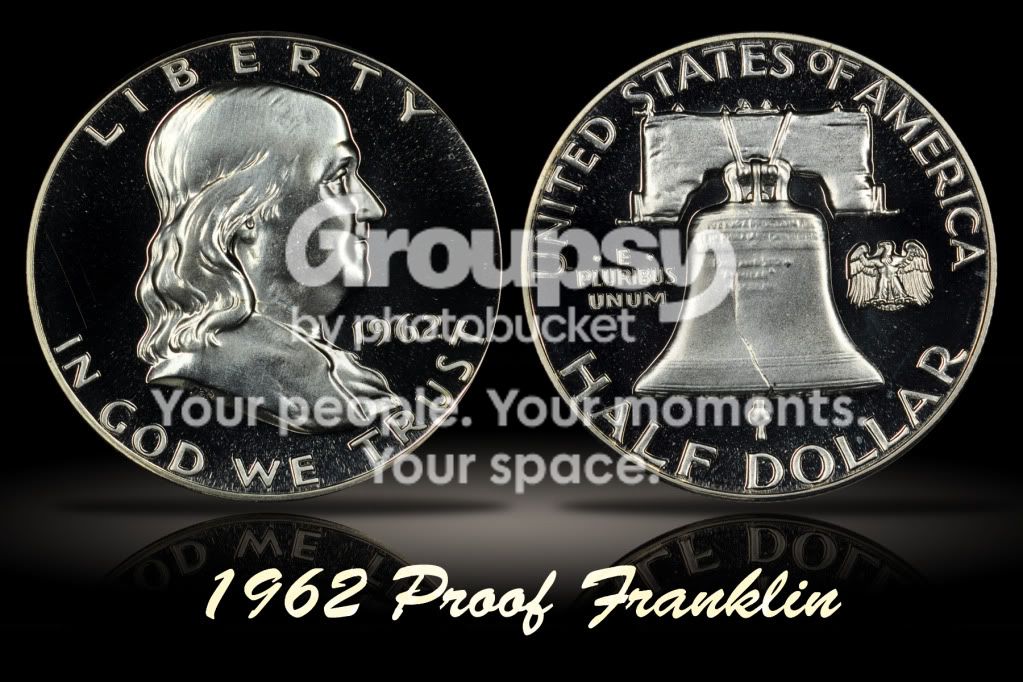

Or, if you're really serious you could go the route I did. I have a Nikon D5000 and a Sigma 150mm dedicated Macro lens along with a homemade copy stand to hold the camera steady. Here's a few example shots from that setup:

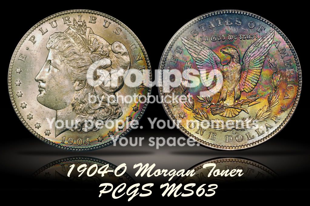

And here's a HUGE shot of a Morgan, just so you can see the detail the lens picks up: (This one might take a while to load)
