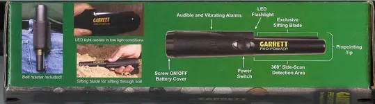

I think they are essential I remember all the times I just couldn't find the object I was looking for.
When I got my first pin pointer it made a big difference now I use the Garrett Pro-Pointer and I love it.

IN LINE
