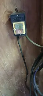

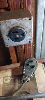

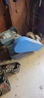

I just unplug my 220 welder and plug the jaw crusher in I bought the plug at Home Depot. The crusher came with a push button switch wired to the motor I just added a plug. No air switch I'll try and take a photo latter I'm cooking quartz at the moment.
