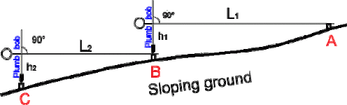

You are right. You should not measure distances following the slope or your claim will be short. Actual ground measurement doesn't count.
Measurements are taken on the horizontal. Here is an example of how that's done in real life.
Heavy Pans
So a person could mark what they think is the heart of the lode deposit, find the slope in rise and run, maybe use a four foot level carpenter's level and a ruler at about the average slope, and using a bit of Pythagorean Therum figure out the length of the claim measuring along the hypotenuse. Then just measure uphill and down hill from center of lode deposit.
