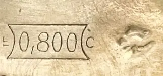

It has a hallmark, but, I can't quite make out what it is. Looks more like a bird (a turkey maybe?) The box has 0,800 in it, and there's a JH stamped below and left of that, and an 8 stamped in the lower right. Toward the bottom is 47554 which I presume is the serial number and it is stamped into the outer cover and inner mechanism frame as well. I'll try and get a decent photo of the hallmark.......
Here's a couple of photos that may help. The hall mark in question is above the 800 box. In looking at the one, I see what looks like a tiny T inside the hallmark box.

Thanks. That helps. Although I said a new standard of .935 was introduced at the end of 1887 (largely to ensure compliance with the British Sterling standard), it was still permitted to produce to the .800 standard until the true Sterling standard of .925 was introduced on 20th June 1933.
Most case-makers didn’t want to carry two standards of silver and produced only in .935 (with a bear or three bears mark) for export from 1888 onwards. Non-exporters, those prepared to have two standards in operation, and especially those who didn’t regard Britain as an export customer continued to use .800 silver. The mark for .800 from 1880 until 19th June 1933 was a standing bird called a “coq de bruyère” facing right, like this:
That translates to English as “heather cock”, which we also know as a “wood grouse” or “capercaillie”. So 1880 would be the earliest possible date for the case (and 1933 the latest possible), but there only seems to be a record of watches marked for Louis Jacot of Le Locle from about 1900 onwards.
I can’t make out the “tiny T” in the hallmark box but, if you’re seeing it correctly, it will be for the Bureaux de Contrôle (assay office) in Tramelan, Switzerland. That would make sense as the nearest assay office to Le Locle… it’s about 20 miles away.
The ‘JH’ maker mark doesn’t ring any bells I’m afraid.
