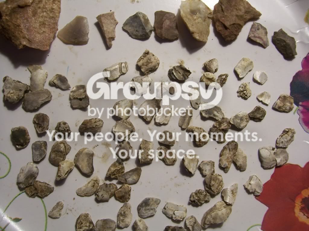

Great insight on the t-net thanks all, Here is my contribution just a handfull of thousands of shell frags in a small area I think was somehow used in pottery production .The rest of the area is great surface collecting and has seen some heavy occupation .
