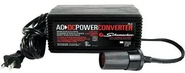

This is the one I use from Walmart $20
Just cut the socket off and put alligator clips on the two wires to clip onto your pump wires.
or else just twist the wires to your pump wires and use tape or wire nuts.
If you are not comfortable with cutting the socket off you can always get an adapter plug to connect to your pump wires.
Cost around $5 or less.
