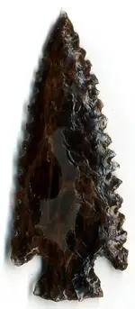

Here's the process, I cheated some though. I was going to go through from the cobble, to the spaul, to the percussion flaking and then the pressure flaking but after digging around in my bag of flintknapping material I found I didn't have a lot of good material left. Furthermore I had already knapped all the big stuff into preforms- had some Dacite, quartzite, and noviculite pieces but nothing really nice so... I thought I could at least demonstrate part of the process- the pressure flaking. I used a pre cut slab (cheating) the end result is the same it just saves A LOT of time in trying to spaul a decent piece. Hope you guys aren't too disappointed - First picture is my tool kit, two antlers, a rock for percussion flaking and grinding, and a piece of leather.

The final product after about 35 minutes or so...and one cut finger- this stuff is sharp

Wow, wow and more wow! Oh and an ouch!
35 min. How in the heck did you do all that? Alright I can see the flaking but the base? Without breaking it? Can you teach some one to do that? Recommend a book?
I am truly amazed!!!!!!!!!!!!!!
I'm sure there's some good books out there- lots of information floating around the net to- wish I would have had access to it all when I was learning to knapp- I just taught myself, but it took a LONG time. You can learn how pretty quick if you have somebody show you and explain first hand though. I had somebody ask me to give them lessons one time- that was fun, they enjoyed it to.
The base is flaked the same way as the rest of the point, just have to have a narrow and hard piece of antler tip to do it, that and apply pressure at the correct angle so you don't get step fracturing- a real problem for many beginners.
Thanks Country Girl- I don't know about talent, more like useless knowledge but oh well... finger is fine, it's just this stuff is SOOOO sharp! One little slice right by the cuticle and you bleed for a while- parr for the course when knapping.
Worthless knowledge, how many people could be stuck in the middle of no where and make a weapon to feed themselves with? Not many today. I'd call it a lost art. But you may want to consider bringing Band Aids.

Thanks guys- I was thinking I should etch my name or something into them to but if I leave a little bit of the flat surface on one or both sides (like on this piece) there's no way anybody could pass it off as real. I'll have to remember that Cayenne Pepper trick- sounds like it would burn a little but I'll try it. I normally don't really cut myself all that much anymore- this was just one of those freak things where a razor sharp flake dicided to lodge itself in my cuticle. I've never used a metal tip to pressure flake but I think I might try that, why not....I've taught myself how to knapp using only traditional tools from cobble to finished point I suppose I could ease the rules a little and cheat a little more... I bet they work pretty good. Although a sharp deer antler works good to, soft enough to grab onto the edge and hard enough to pop the flake off.
