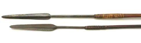

I believe there are stone heads here in South Africa, but most are the iron type like in the picture below. If you find them in a cave then they will be in good condition, but in a field they rust away to nothing.
The Zulu's were famous for their short thrusting spears. In fact Shaka was made famous because of this spear. Get in close and stab, was better than throw and miss.....

Have you ever found any spears like that? Rusty or not I would trade some authentic stone points for one!
