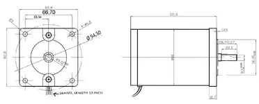

A better choice would be this motor. I just bought one just like it due to the shaft length and diameter. 12vDC Sealed Motor.

Got my 12VDC motor today. First impression, the motor is built like a tank. Its a sealed motor and the quality is superior. It weighs in at 5.1 pounds and has a 3/8" shaft. Will run on 12 or 24 VDC. This unit looks like its new due to the leads. There is a setscrew mark on the shaft as though a pulley was installed but the the four mounting holes do not have a mark on them, meaning it was never mounted to a bracket or had any bolts tighten down on the aluminum frame. I went outside to my truck as I had to see if the motor had any guts. Wearing a welders glove I hooked the leads to the battery, the motor started. Next I grabbed the shaft while holding the motor in my other hand. I for the life of me good not stop the shaft from rotating. This little motor has some guts. Having no clue what the motor was intended to be used on it does remind me of a motor on a CNC machine or used as a drive motor on a wheel chair but this is just speculation. I am impressed though. Will make use of the motor using a PWM. To add additional torque to the motor if needed would be to use RPM reductions using a series of pulleys as I did on my trommel.
Motor.webp Motor1.webp​
