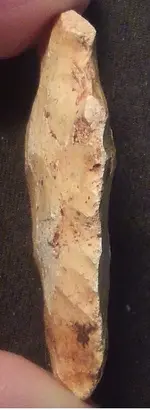

I might as well start with #1. (Please let me know if I'm uploading too many images or if you need different areas.)
Number1-SideB-StarburstCoralClose2.webp Number1-SideA-Close-WorkedLines2.webp
Number1-SideA-Close-StarburstCoral1VNice.webp Number1-SideA-Close-Multicolor1.webp
Under magnification, it looks like star bursts all over the piece and I'm thinking it might be fossilized coral.
If it is coral, is east coast, west coast, or keys in Florida the most likely local for it?
Are these common?
Thanks for any help or comments.

On the first point, it looks to be made of fossilized coral, so would be fairly "local" to Florida.
Nice frame and they all look authentic. Definitely Florida material, Starburst Coral. Pretty rough shape so an exact ID is tough. I'll just say it's a nice stemmed point. Bone pins are great, & I'll agree with the claw being an antler. JMHO. Nice you got the frame and shared with us.

The "Starburst" look to it was spellbinding when I first looked with the loop. That must have been tough to work into a point.

For Coral, probably Tampa (gulf side) and surrounding counties. Maybe North and East of there as well.
Thanks Joshuaream.
I suspected the west coast near Tampa because of the activity there. But I had nothing to relate to other than some Youtube videos showing guys collecting fossilized coral pieces from some rivers in NW Florida. Any idea what the darker blue/green flecks are, in the last image from Point #1?

Sorry about the delay in following up with more images of points. (And please give me some guidance if posting individual items is preferred or groups of them are best. Or maybe groups of what I think may be from the same culture?)
Again, please fill me in on the culture you think it might be from as well as the types of material used. I'm not familiar with the actual names used. Thanks.
Point #2 (from the initial post)-
Number2PofileB-RightBaseNotch.webp Number2Tip-Close2.webp Number2PofileA-Base1.webp
