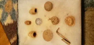

Sig Line, why are you opposed to using tracking vs. pumping all the time? I also note that on the ORX you don't even have the option to use tracking or to set ground sensitivity. Didn't prevent me from finding these relics a few weeks ago, including some old 1830 Silver. Like I said previously, the main issue with improper setting of GB low is ground noise, not loss of depth or sensitivity. So if you are not getting a lot of ground noise, then you are probably not missing a thing.
