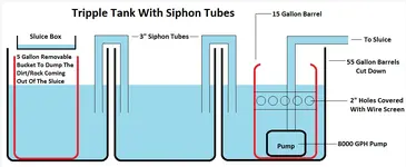

You will need a tub within the lower tub to catch all the dirt and rocks or this tub will fill quickly with dirt and rock. The tub within the tub needs to have a bunch of small holes drilled in the bottom to drain the water off so that you can pull the tub out and dump the dirt and rock without losing the water. Then replace the tub until it fills again with dirt and rock.
Better yet is to use a three tub recirculating system and use siphon tubes. The siphon tubes suck water from the center of the tubs and any floating crap will not reach the tub containing the pump and you the user will skim the crap that is floating. Plus the siphon hose will keep the tubs perfectly balance in water level. This system works great. Another option is to get a section of Master Cool cooling pad that is 7 inches thick and you use it as a water filter in the tub containing the pump. The pad needs to be tight from side to side in the tube and not allow anything to reach the pump side of the tub. The pad needs to be position in the tub so the holes within the master cool pad are going uphill, the dirt and crap will not flow up hill and will settle within the pad. I have a triple tank system using the Master Cool pad and it works fantastic in keeping the sludge out. Remember for every 5 gallons of dirt that you put into your sluice 95 percent of the dirt sand rock is going into the tub that the sluice dumps into. You need a means of capturing that dirt and dumping it.

Here's my siphon tub
The size of the siphon tubes are in relation to the amount of GPH's your pump is delivering. Will not hurt have much larger tubes as soon as you turn your pump off the siphon tubes will sit idled until you turn the pump back on, provide the siphon tubes do not lose suction. I built my tubes out of cheap 3" white drainage pipe from HD and two elbows and make them in a U shape. Then to get the siphon started you submerge the entire U tube under water getting all air out of the tube, then with a rubber ball that fits the ID of the tube tight plug one end, next pull the ball in over into the other tank making sure the other in of the tube stays submerged. Then remove the ball and you will have suction until the tanks balance out. Once the pump starts drawing water the tubes will begin their siphoning to balance the tanks.
My attempt at a 3-tier siphon ~ fail.. 2-tier also ~ fail.. Try try again.. 8)
The size of the siphon tubes are in relation to the amount of GPH's your pump is delivering. Will not hurt have much larger tubes as soon as you turn your pump off the siphon tubes will sit idled until you turn the pump back on, provide the siphon tubes do not lost suction. I built my tubes out of cheap 3" white drainage pipe from HD and two elbows and make them in a U shape. Then to get the siphon started you submerge the entire U tube under water getting all air out of the tube, then with a rubber ball that fits the ID of the tube tight plug one end, next pull the ball in over into the other tank making sure the other in of the tube stays submerged. Then remove the ball and you will have suction until the tanks balance out. Once the pump starts drawing water the tubes will begin their siphoning to balance the tanks.
I just tried to make a three tier syphon system, and I failed miserably.
Then I tried just two buckets, but that also couldn't siphon the water fast enough. I don't have any 3" tubing, so I was using a pair of 1/2" hose lines, wire tied together. It was siphoning, but no where near quickly enough. I'll grab some 3" hose from Deseret Industries or something. I don't need anything pretty, & just a couple 3 foot runs should do it.
I'm using a "little giant" 550gph pool cover pump, and a regular garden hose with 3/4" ID into a bucket sluice.
I also need to get a hose T with valves, so that I can regulate the water flow better.
A trick I did pick-up about the siphon'ing: use a large glass jar for the ends of your hose, this will help them stay under water (when the jar is on its' side), and if you stand the jar up (while the rim is submerged), it will minimize the amount of material that gets into the jar.
One of these days I will just put a large hole in a couple buckets, and make a connection using a REALLY big tube, but then I gotta put a filter on one end, and that could clog up..

You need large siphon tubes. You want to displace the water in the tanks at a fastet rate than your pump or pumps can deliver. Otherwise the pumps will drain the tank and you will lose suction.
