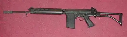

FN FAL. Way more accurate than most AKs, will drop most anything that lives in North America with 1 round, adjustable gas system, .308 caliber, used by 90 countries including most of NATO for many years. Tons of parts & mags available. What's not to like.... :laughing7:
