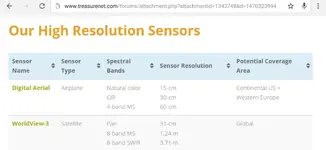

Airplane - 15cm
Satelite - 31cm

I didn't notice before because I was looking at the full resolution image and didnt make it down to the lower left hand corner, but it does state there that the resolution is 40cm GSD. So GSD is ground sample distance and is the distance between the pixles, I guess Im not really getting how that translates into 1.25 meter resolution.
Airplane - 15cm
Satelite - 31cm
If you look at the reference in my previous post there are airplane images with ~8cm resolution, and clay diggins is right the 31 cm is panchromatic or black and white only, and mapping companies dont use these ones. but in the image that I posted that is full color from the worldview-3 satellite that you referenced is listed at 40 cm resolution
The 40 cm GSD is only the onboard sensor resolution for one band (black and white). As I pointed out before due to circle of confusion (and several other factors) a color image will be always lower resolution than a single band black and white (panchromatic) image under the same conditions.
In the second paragraph of the page you linked to is the following resolution statement about the satellite images available:
WorldView-3 provides 31 cm panchromatic resolution, 1.24 m multispectral resolution, 3.7 m short wave infrared resolution and 30 m CAVIS resolution.
Your best possible color resolution is 1.24 meters.

Clearly the best color resolution you can count on is 1.38 meters = 54.33 inches. Which coincidentally is the maximum resolution the U.S. government allows for public use of color satellite images. Just the same maximum available resolution I have stated several times in this thread. :BangHead:

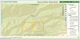

Ok, well changing gears a little bit to the second part of the question I first asked, regarding how to best use the maps that are available.
When I am looking at claim maps on myLandMatters I see the boxes that cover the areas with claims.
like this
On some of them it says one claim and on some it says two, but the boxes remain the same size. So do the boxes actually represent the whole area of the claim, or is it just a reference area with the claims defined further somewhere else?
Thanks for the help
thats one section (640 acres) if you select the "i" identify the claim record will say NW, NE, SW, SE,(160 acres) they break them down further into aliquot parts
as in N half, S half, E half or W half so NWSW (40 acres) is in the SW corner and is
as close as you get from BLM record, to see the full description you would look it up at the county recorder.
a description of a 20 acre claim would look like "the N1/2 of the NW1/4 of the SW1/4" of sec. 5 township 32S range 5W of arizona meridian
http://www.blm.gov/or/programs/minerals/files/section.pdf
The other tricky bit is when you get to the county. Each county has a way of filing and indexing the documents recorded there. Unless you know which pieces of data are used, you may be unable to find the claim fling. Simple solution: call and ask!
like this
Thanks for the help
Winners58 gave you the correct answer. Each box represents a Section which is most often (but not always) a square mile. The "i" tool will give you the details on each claim with links to the Serial Register page with the claim history and details. You can get more information about the Public Land Survey System (PLSS) that defines those sections in the Land Matters Tutorials pages. There are videos and papers there that go into detail on the PLSS and determining land status.
The Mining Claims Map page that links you to the mining claims maps has some brief but important instructions about just what is on the maps and how to use them.
The mining claims represented on these maps are only displayed to the nearest section and DO NOT display the actual claim location. Sections are about one square mile and actual mining claim locations can vary considerably from their mapped location.
The only way to determine an actual claim location is to obtain the County Recorder Location Notice and amendments for the claim in question, study the mapped location and then find the location marker on the ground. Members of the public and other prospectors do not have the right to determine whether and existing claim location is valid, only a court of record can make that determination.
