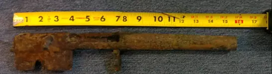

While bank fishing I spotted something sticking out of the mud that met my criteria for further investigation. It was too round to be natural and I could also see a straight edge. Reached out with a long stick and moved it closer producing a cloud of silt, made a few more casts while waiting for the cloud to float downstream. Repeated this 4 times until it was close enough to reach and pulled it out.
Cleaned it up with 10 amps for about 4 hours. Turned out to be a sawed off 12GA. It had probably been in plain sight for years. People just don't see things.

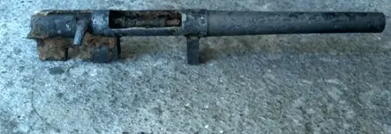

"met my criteria for further investigation, too round to be natural and I could also see a straight edge" - Cheeserock you've a good eye and I certainly understand and appreciate your criteria though I'd never put it into those words before however the moment I read your statement I smiled inside as I knew exactly what you meant. Good observation, the preservation method is quite interesting, what did you use on the negative lead, cathode I believe it would be called with the find being the anode, yes?

Simple cleaning. Negative to the barrel, positive to the 2 steel rods. Solution of salt water and baking soda changed 3 times. Wash with Dawn dish soap and a coating of Remoil.
