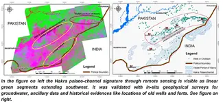

Hey Chub...... thanks for your interest ..... it sank in 1760 so no railways then,....the flood plain of the river was 3 miles broad..too wide for an anchored ferry......but i take your point for clues ...... will give it a think.. meanwhile have asked a govt space org to do some satellite imaging to locate the old bed. they did it in the desert to locate the bed of a river that dried up 2000 years ago. am attaching the image of that for your interest....Thanks for your advice on the two box detector...will educate my self on it and get back to you with questions. RIVER HAKRA.webp
