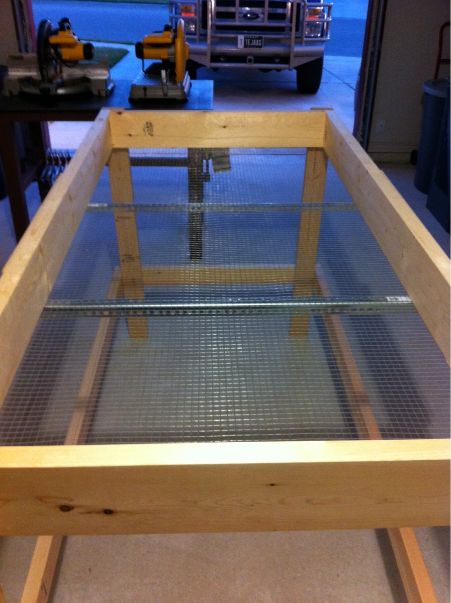

This is one of the 'test pit' tables i use. It is a fixed-top table that measures 3'x6' - with a 1/2" bed. I also use 1/4" drop-ins if i need to go down a size to adjust for site/material conditions.
We typically only use them for the test pits we survey prior to establishing a new field site because they are practically disposable (hence the hardware screen) and extremely portable. They are also convenient because the legs/trusses can be removed & reconfigured to adjust for whatever location/terrain/purpose we need... After about 6 months of regular use they start looking like they got hit by a train, so we scrap em and build new ones.

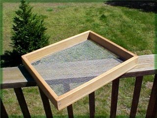

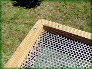

I never go anywhere without a few 'trays'...
These are stock photos, but ours are identical with the exception that i stain mine a bit darker and seal them with a good coat of spar urethane:
We run them in 3 sizes, with each "pair" having a 1/4" or 5/32" perforated stainless steel option.
-2 each 12"x12"
-2 each 18"x18"
-2 each 24"x24"
Depending on the site/conditions is what dictates which trays come with.

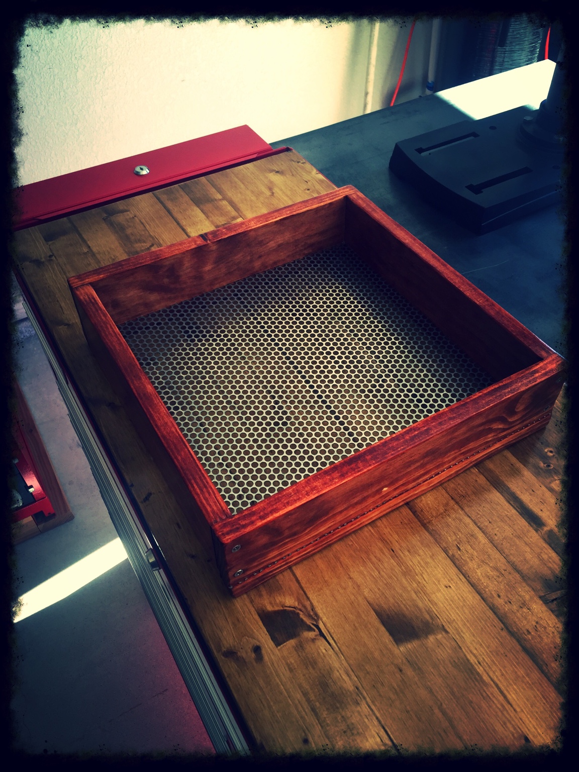

Just finished building, staining & poly-sealing another small screen.

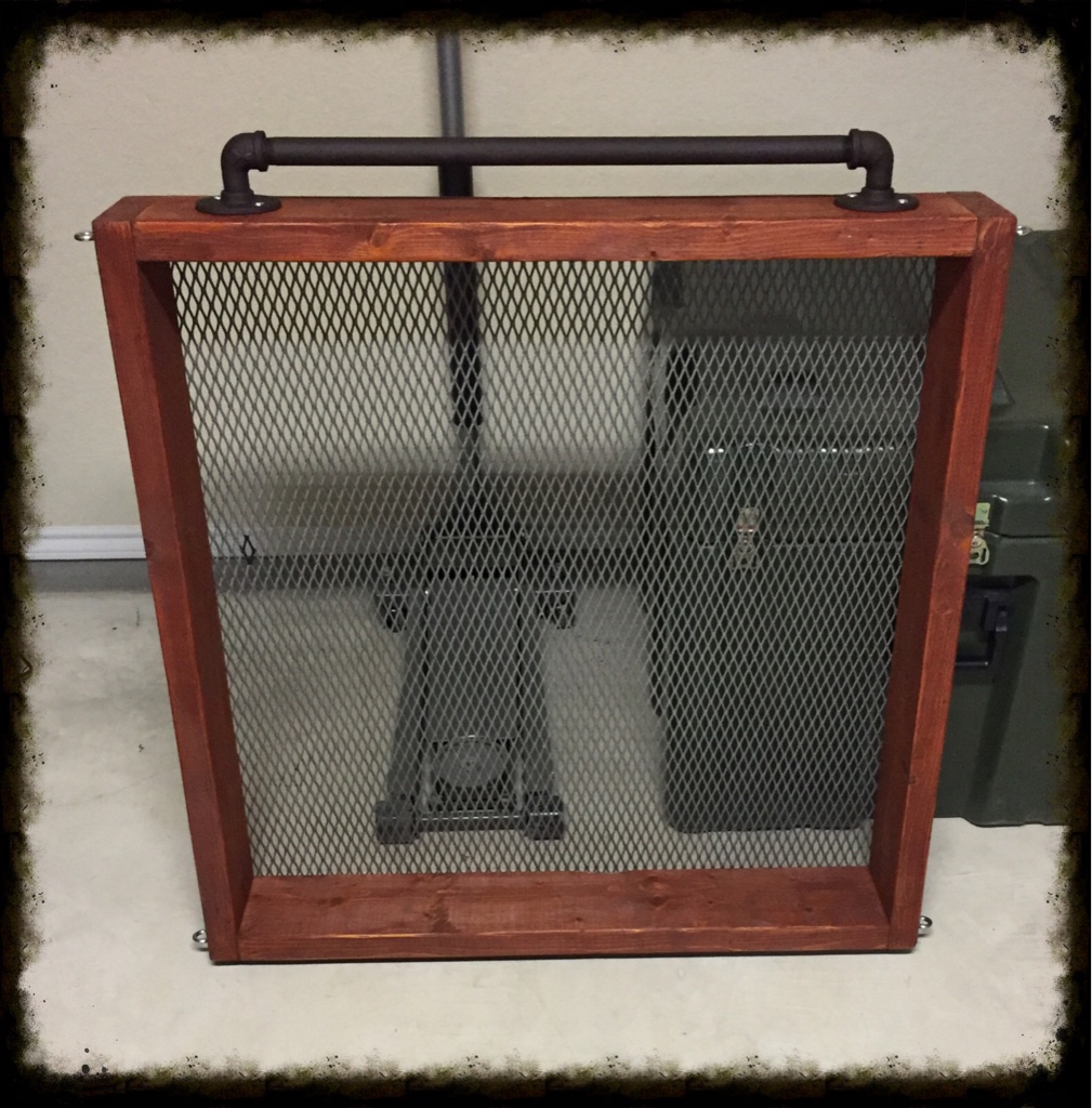

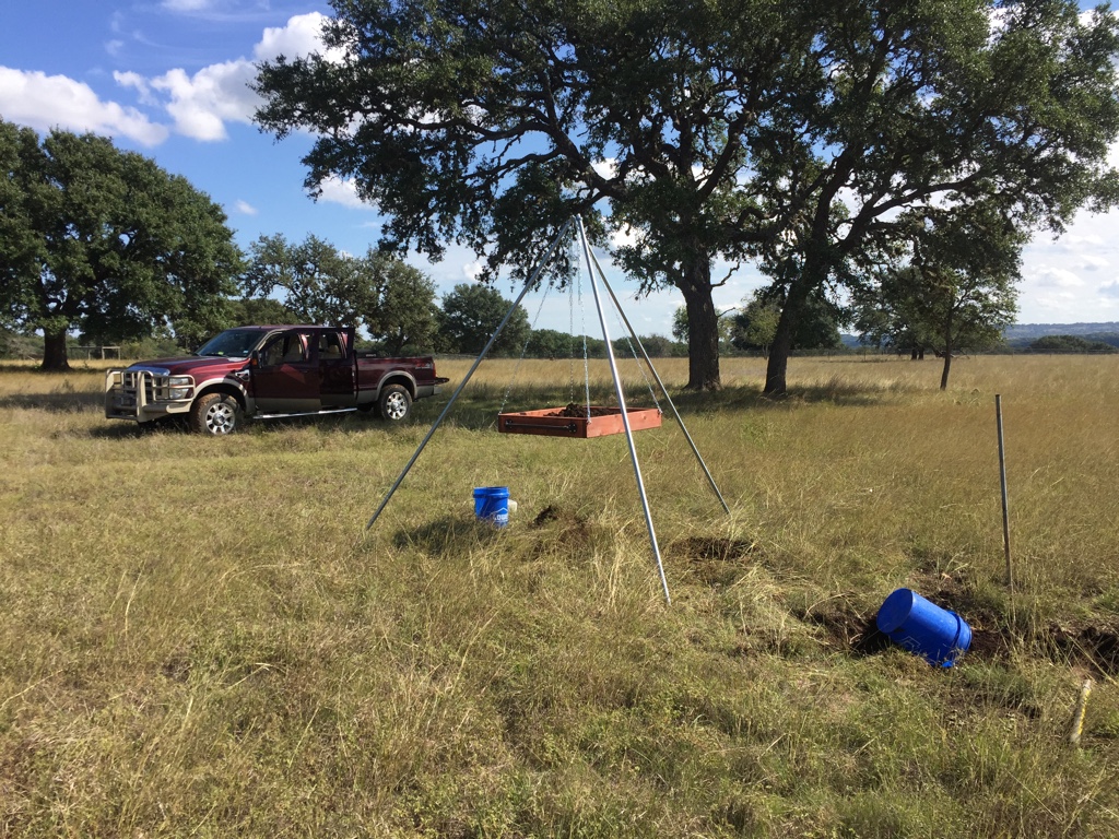

Here is one of my tripod sifters that i use for site surveys.
This was taken yesterday as i was opening a test pit on an (currently grassed-over and fairly muddy) encampment i plan to excavate this winter.
The box measures 3.5' x 3.5'.
I like to weather seal the 2x6 frames and then use 3/4" water pipe mounted with elbows and flanges for a handle.
The beds are 1/2" expanded steel. Some of my sites will occasionally warrant the use of 'drop ins' (a 1/4" perforated steel bed with an angle iron frame that fits inside the 1/2" screen boxes i typically use).
