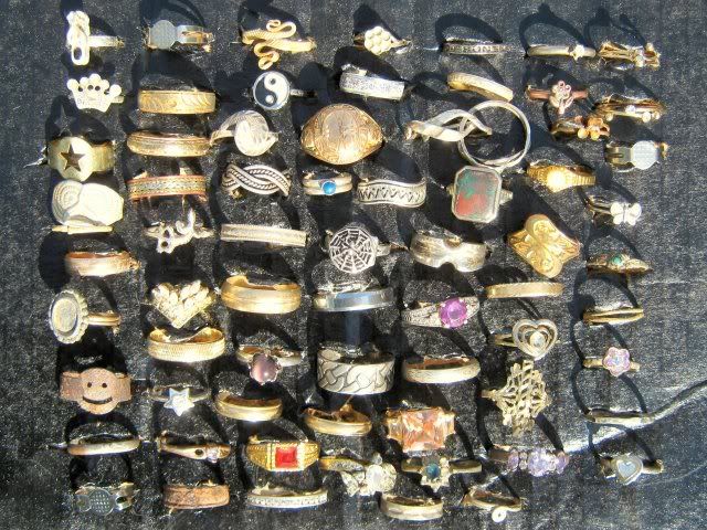

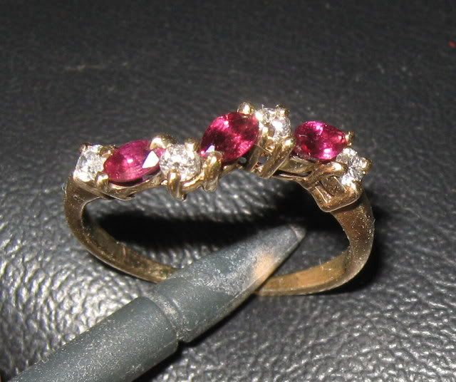

Diggin lots of these,
will get you some of these.
And I don't dig that many rings compared to ear rings and
pendants and stuff.
Happy Huntin,
Tabdog
