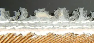

I'm using a new mat called Vortex that is excellent in catching fine gold.
Ive been working the Oregon beaches for 3 to 4 years now and find this
to be the best matting Ive ever used.I have ran close to 250 to 300# of
cons and i'm only loosing about 5 or 6 specs of gold per hundred lbs.
of cons.This is not a scientific test. At any rate I'm very pleased with
these results. Has anyone else used this Vortex matting? Happy to
answer questions ...Strech

I just started using it this year and I think it's great! Unlike Nomad (miners moss) or carpet, this stuff doesn't load up with anything but the heavies.
It's easy to clean, it's waterproof, the fine gold doesn't get lost in carpet fibers and you don't have to run ribbed rubber under it. Just the Vortex mat and that's all. And for fine or flour gold you don't even need riffles or expanded mesh just run the water slower than usual and the mat does the rest.
*Note: Be sure to run enough water over it to eliminate excess air bubbles before running your pay dirt.
I expect many will convert to it once they have seen it in action.

Thanks for the welcoming. As soon as I learn how to send
pictures Ill show you the Vortex matting i"m using. There seams
to be many variations of the rubber pattern.I'm sure that many of
them do an excellent job.

DSCF6101.webp001.webp002.webp003.webp[attach=5
Here are the pics of the vortex matting i was going to post, sorry it has taken so long to get them on here.

I have that material in bulk and am getting 7 bucks a square foot plus shipping. It is heavy material. Do not leave it out in the sun dry for extended periods of time (after about a month made a sample of mine a bit rigid).
I am building a one of those sluices that open wide, than narrow, than wide again for fine recovery using this material. Will post video when done, should be up by mid-July.
