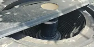

its no good for what i want, thats not a continuous reverse spiral riffle. maybe you could fill in all their riffles with something like a fiberglass bondo and gel coat it then glue the extruded rubber riffle to the gel coat surface. thats probably the easiest and cheapest way to do it. im probably going to need atleast 8 of them. now we just need to get a good look at the profile of their extruded riffle
and chop off those scrubbing paddles so they dont blow the gold out of the riffles
Can extruded rubber riffle be spiraled (attached) on a wood base or metal base?
im pretty sure they just use rubber cement to glue it their abs bowl
If it is a tight fit maybe super glue would be better?
Like gluing mats together.
the moderators wont let me post a link right now but i found a reverse spiral bowl for $200, it wont have the right profile but you could glue a extruded rubble riffle to it
Wow at least it is out there to use for a build. Thanks.
click on the other members link and when you get you there just search neffco bowl and youll see its $200
Not sure the link will work for a search of neffco bowl????
Neffco bowl:

neffco bowls are made from abs and shouldnt be left out in the sun or cold, they need to be protected, those are the guys that i say mine the miners, trying to sell old equipment thats been abused and trying to get top dollar for it. pretty much every ad for blue bowls come from them and another crew.
the 3rd picture looks like a reverse spiral but i think it would just be cheaper to buy a unit from china and just modify the bowl when you get it. heres the link

I shared the link but the moderators took it down, I guess we're not allowed to advertise for people that don't pay to advertise here. Im not sure how to get around that. My powers out and I'm on my phone atm. Yes that picture is what I was looking at because the first foot on the bottom has been opened up and laid flat so you can see the inside of the riffle. I think the profiles should look similar to a cresting wave
